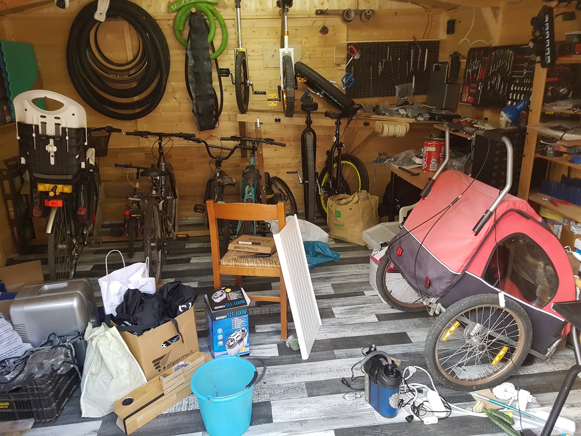

Ok, thanks now I know where those bearings in my garage came from.
