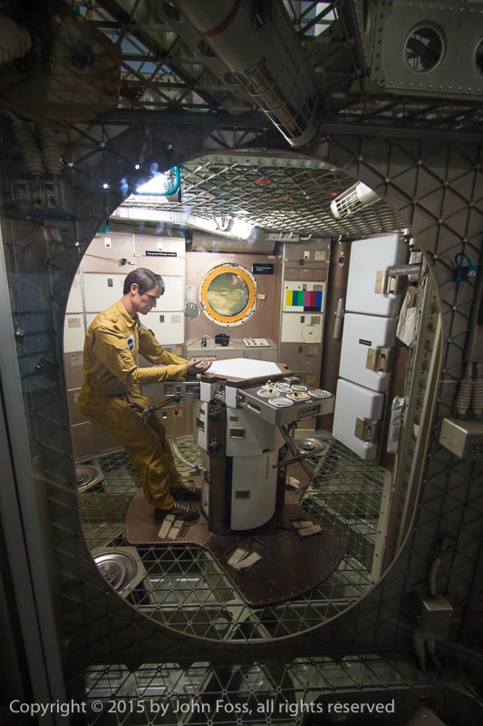

BTW, you can get an up-close look at those storage bins/lockers if you go to the Smithsonian Air and Space Museum in Washington DC. They have the mock-up of Skylab that was used for training. But it suffers from gravity.
