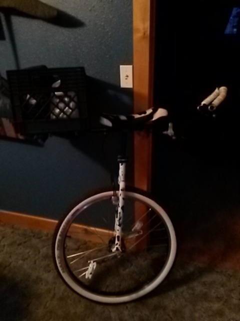

I know I’m a bastard but I couldn’t resist.
I like it!
Just looked and the picture I took sucks. It’s a milk crate hose clamped to my t.
Are you… the Moonicycle Milk Man…?
Could you please post a more detailled picture of your t-bar?
I ended up taking the milk crate off. It was just too big and was driving me nuts.
This is the most detailed pic I have at the moment.
