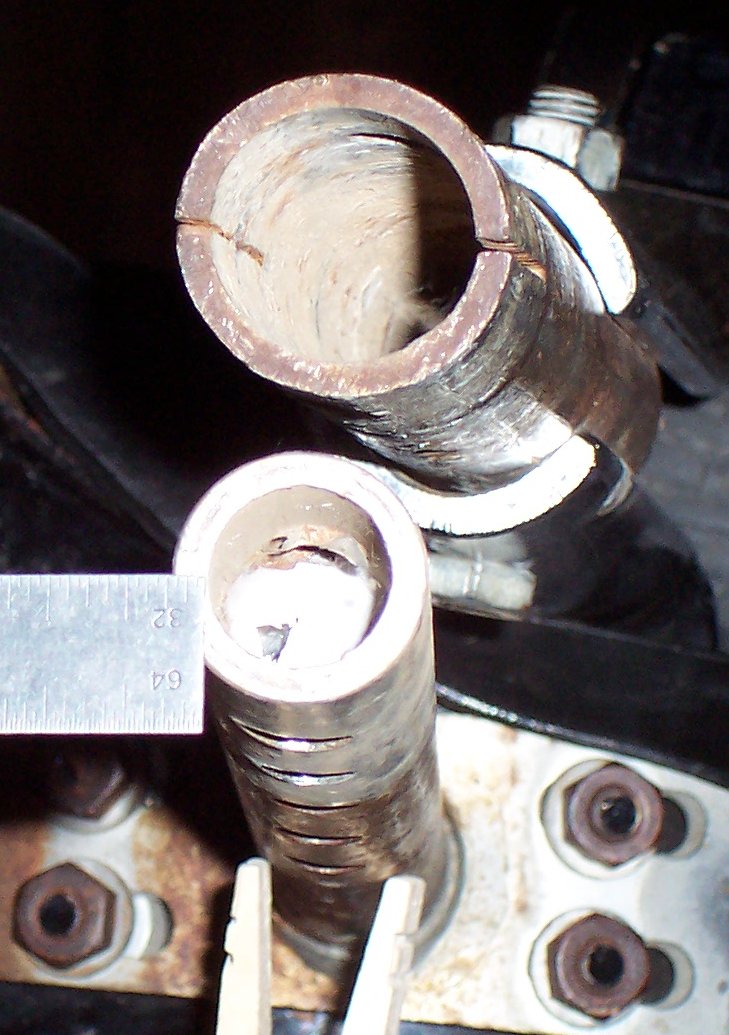

My post is steel, with a welded seat bracket.

Ok , I have to dissagree about bending these …
Heres a closeup.
Maybe the schwinn post you had isnt constructed this way …?
See how thick the steel is …?
I’ve got to tell ya … I have beat this post hard for 36 yrs.
The size of this post (Dia.) allowed me to slide another steel pipe over it too :smiley:
If you really think your going to bend it … :stuck_out_tongue:

I’m gonna get another photo for ya for reference , gimme some time :thumbup;
Steel post thickness is 1/8"
I’m not trying to argue anything here …
… trying to be helpfull when selecting a post.
Showing the ‘girth’ :smiley:
