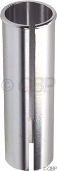

Shimming a 25.4 post to 27.2
Anyone done this? The question is whether the shimmed smaller post would create a potential to damage the frame. I’d rather not do this since it’s a brand new KH - and it’ll probably be the last uni I can afford for a very long time. If there’s even the slightest hint that it would cause porblems the thing to do would be to save up and just get the larger post.

We have a non-adjustable post we used on her trials, but it would need to be shimmed up from 25.4 to 27.2.
I’d also be very interested in trading our KH adjustable 27.2mm post for any 27.2mm non-adjustable… if anyone is interested. Our 27.2mm adjustable post has about 5 inches of post left, so it would still be ideal for a 36er.
The shim should not do anything negative to your frame. I’d say go for it, it’s gonna end up cheaper than a new seatpost! Koxx-One unis used to come stock with a shim (29.2-27.2), I dont know if they still do, I dont know if they’re still produced!
Also. if it stills doesn’t work, cutting the frame off a little bit would be the only good solution, I’ve done it myself because my friend was too short for the KH20 Longneck I sold her. If you have a dremel to do the job it should be really easy. We can’t really notice a difference, except that it’s about 1" lower than the original Longneck.
I am running a shim on my kh long neck as we speak! and k1 still shims their frames
I used a short bit of electrical conduit to shim the post on my giraffe. It only goes about half way around the seatpost and I had to put a lip on the top edge to stop it from falling in when installing it. It’s been on there for years with no negative effects.
If you have access to some scrap metal bits, you might be able to make due without buying something for it.
The Conundrum comes with a pack of shims, many Ti frames are shimmed, so no it’s not wierd and it will work, though it may allow the seat post to move around a little more.

UDC used to sell these shims but I don’t see them on their web page anymore.
I have two of them 22.2 /27.2 & 25.4 /27.2 that I have used on my KH uni’s for dropping in spare seats with short posts for shorter people that I am teaching to ride.
