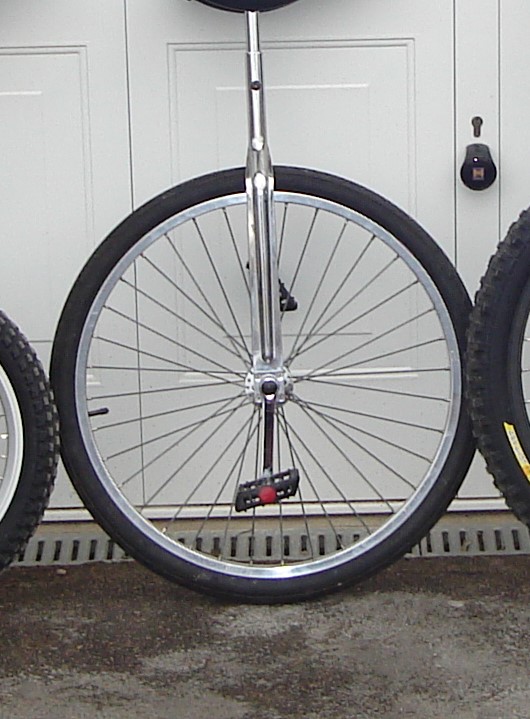

Thanks for the replies, I didn’t have a picture that could be posted, but here it is…
That looks like a Schwinn frame and a tight fit for the tire and wheel that are on it. It looks like the tire comes really close to the inside of the crown. Maybe it’s a 24" unicycle into which someone squeezed a bigger wheel.
The spoke lace pattern looks interesting like it’s only a one-cross or two-cross pattern. Kind of weak for high-torque pedaling but great strength in compression.
It’s a Semcycle! Based on the Schwinn design, but with refinements. Note the odd spoke pattern (cross 1). Original Semcycles (1985) came with radial spokes. They look really cool, but don’t hold up well without constant truing. The cross 1 pattern seems to work fine. I didn’t know they came in 26" but if the tire doesn’t rub, they certainly did! And it has the best square taper axle you could get back then, which is saying a lot, since there weren’t any splined unicycle axles at all.
Oh, just saw Harper’s response. The Semcycle frame has a “bump” down the middle of it to make it more rigid and allowing for less material (I’m pretty sure they were lighter than Schwinn’s).
It could indeed be a 26" wheel crammed in there, but as those frames (Schwinn, Sem, Others of similar design), it would be terrible if there’s tight clearance. I know this from experience, having tried to cram a 26" wheel (with knobby tire) into a Schwinn frame back in the 90s. It was my first purpose-made Muni! Even with a spacer to push the frame halves apart, it still rubbed like crazy whenever you pedaled hard. So it was fine as long as you weren’t going downhill or uphill! :stuck_out_tongue:
Ah, I see it. It’s not just a flat bar of steel like the Schwinn frame.
