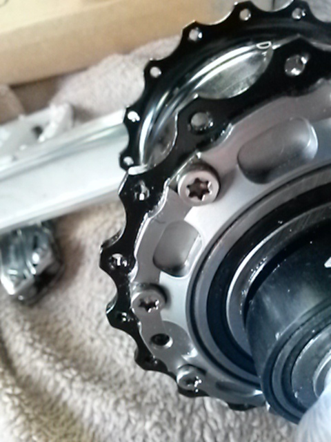

Also, once I had the hub de-laced, I notice two brown marks on the silver side of the hub. They look like cracks, but I can’t feel them at all. What say ye?

In the picture above, the brown mark is right in the middle of the picture, just below the 3rd spoke hole from the right on the near-side flange.
Better pictures…
Seems to be under some kind of clear coating on the hub. I tried picking the line with a tooth pick and my nail and can’t feel anything (seems smooth).

I don’t think I would worry about the brown line. That is not a very likely spot for a crack to form, but definitely keep an eye on it.
