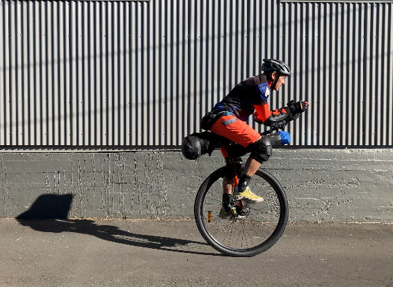

Today, I did a trial of my partial unicycle setup. Before today, I wasn’t sure I could ride it.
Shown below is sleeping mat on front, sleeping bag on back. I trialled 2km ride with tent in backpack…and will add another bag hanging off back bar for camping stove and other gear…also will add more clothes in backpack.
IMG_4686
I’m so happy to say I could ride the setup (127mm crank)and it felt very good. The front and back loads seemed to balance each other and the ride was not too different to my usual ride without the loads.

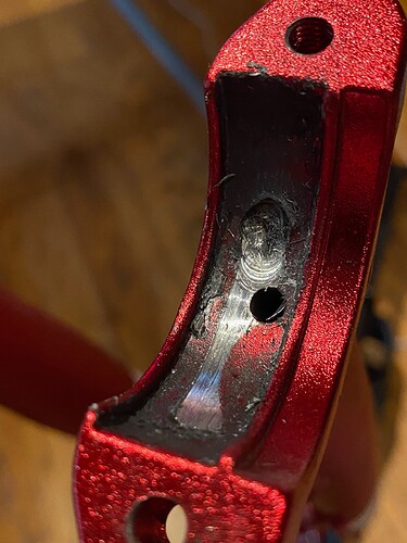

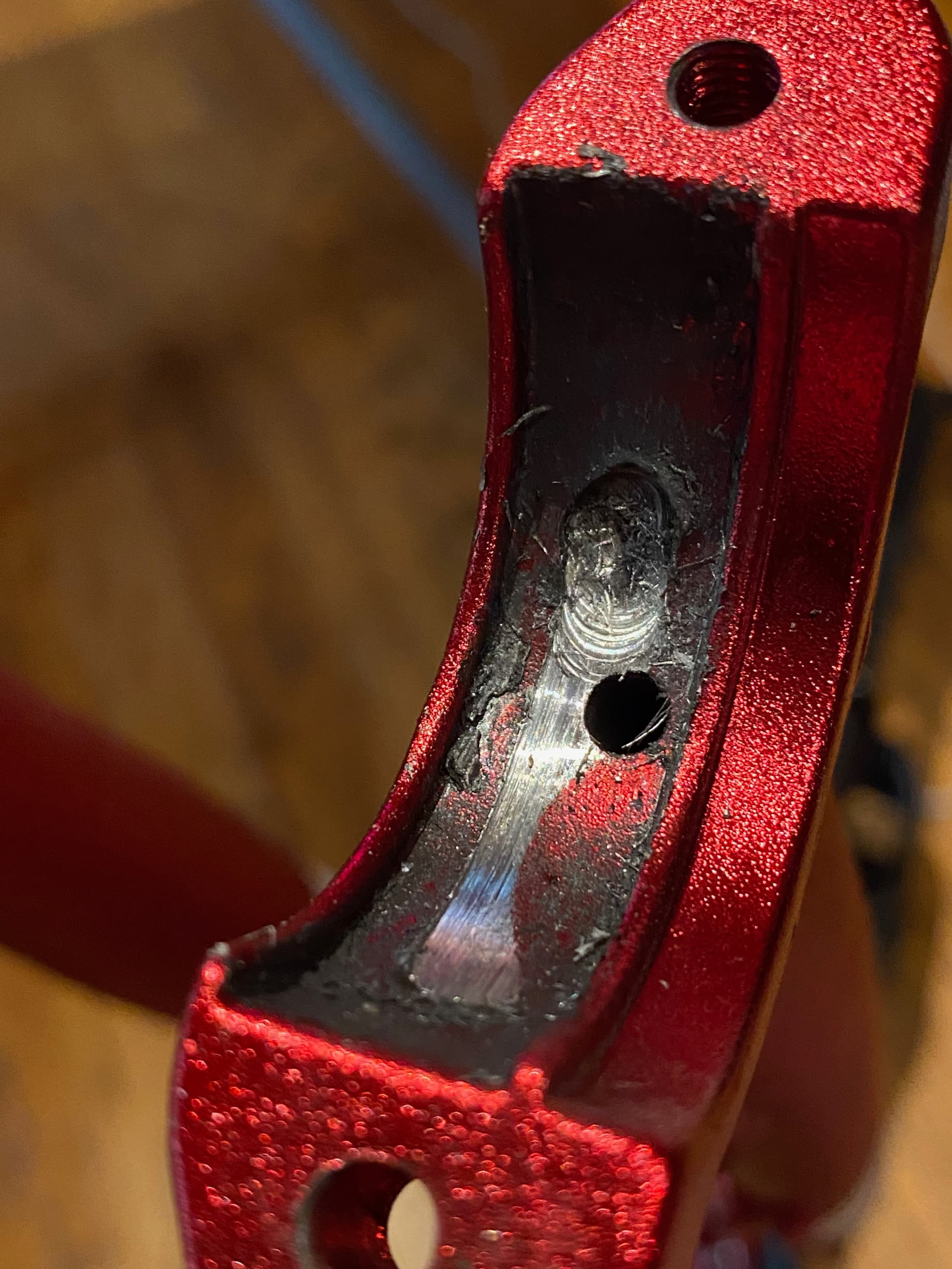

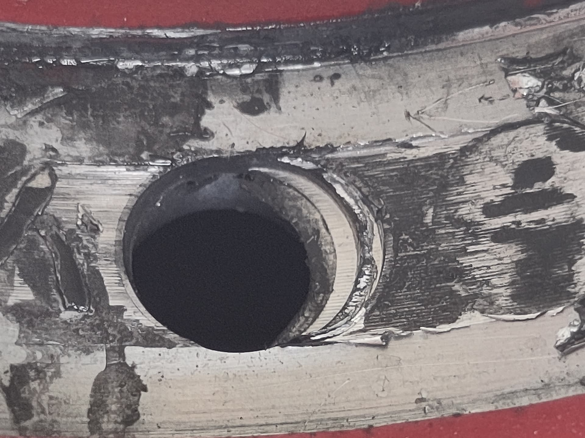

So, it turns out my learning problems with the slop in high gear were all mechanical, and not in the hub.
After talking with Florian I started disassembly, getting ready to de-lace the wheel and ship the hub to him for inspection. When I pulled the hub off the frame, I found aluminum shavings all over the bearing on the high gear side. And the frame tells the story:
That’s right, the slop wasn’t in the gear at all - it was bearing slippage. The recent “maybe the clutch is broken” where it slipped when I applied force was clearly the anti-slip pin working its way out of the very damaged hole.
I know the bearing caps were tightened to Florian’s specs (6 Nm), and I checked them at least twice over the last few months. So when I reassembled it I added a rubber shim in the bearing cap on that side, and decided to push it to 7 Nm.
Lo and behold, I can ride it in high gear. Not really well, but that’s just time in seat now. I went something over a mile in high without much difficulty. And the slop I was experiencing is completely gone.
I’m prepared for the new hole I drilled to fail, and if it does, I guess I’m flipping the frame (or the wheel/cranks). Aluminum is fairly soft (it’s 6061-T6 so it doesn’t really get better) and doesn’t seem ideal for this sort of detent…
I’ve had the same issue on my Flansberrium alu frame :fearful:
I think it was due to a loose bearing cap. I had tightened it again and it doesn’t seem to slip now. But it has damaged the frame, so I’m still cautious. I have submitted a few ideas to Jakob so he can think of a better system for his custom frame.
For standard frames, though, I’m not sure whether there’s a great solution. Maybe drilling the hole in the lower part of the bearing cap, so that it’s easier to replace if it get damaged.
I’d thought about that too but transmitting all that force through 2 bolts in aluminum makes my spidey senses tingle. I think adding a rubber shim over the damaged holes is probably a better solution… and I hope I never have to find out :slight_smile:

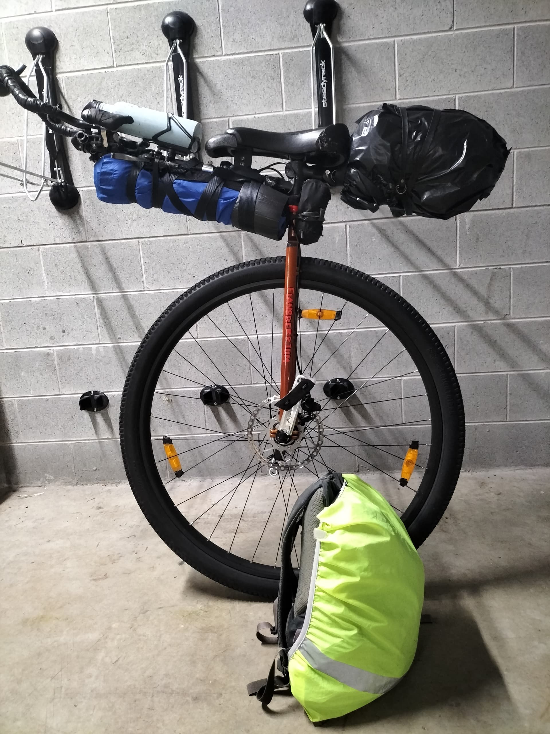

After a bit of trial of Uni-packing setups for my G36, I am now relieved to have a setup that I am comfortable riding.
I
now feel that I can change back to my 127/110 cranks.
I really need 110 cranks in 1:1 gear as an alternative to 127mm in 1:1.5.
Being new to Gears 110mm cranks in 1:1 gives me more control for similar speeds to 127mm 1:1.5.
127mm 1:1 is the easiest gear I need.
Interestingly enough this is how the new KH frames come from the factory drilled. One bearing cap has the hole in the bottom section and it works well. Really helpful to be able to see the nub is in the right place and hasn’t moved.

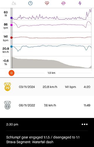

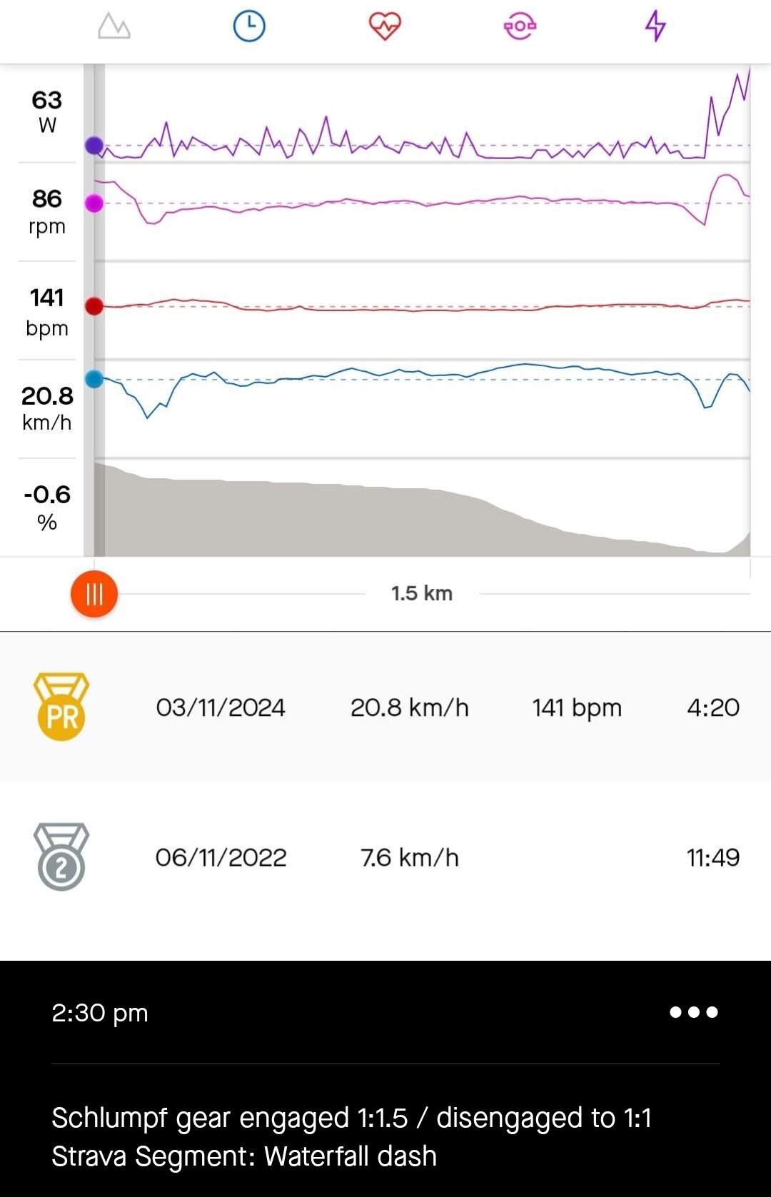

Extract from my Schlumpf commuting in high gear. Strava:
1:1.5 gear engaged x 3 times:
65rpm=18kph Iron Cove Bridge / Bay run
69rpm=18.7kph Lyons Rd West
80rpm=23.5kph Majors Bay rd/ Norman St
Slowly but surely learning to ride in high gear. One day it may become as intuitive a feeling as in 1:1 gear.
The D-brake adapter shows that a lot of torque can be transmitted and pedaling forces should be a fair bit lower than braking.
One needs to make sure that the bearing clamp can be seated on the backside. (To prevent this bolt from being unloaded and loosening, as well as distributing the force to both sides of the bearing clamp). Either by using some 3d printed spacers (3D gedruckte Lagerspacer für QX #rgb Gabel – QU-AX DE) or a stack of shim washers.
