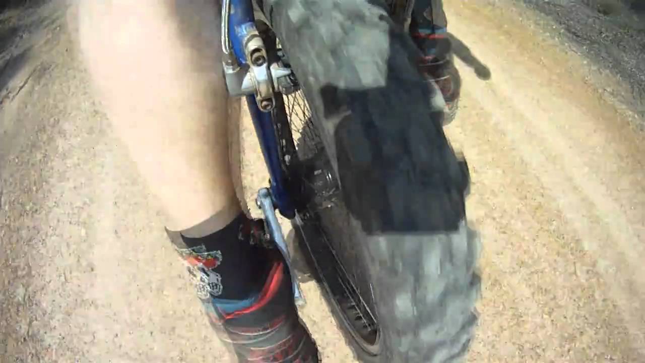

Absolutely. And with the shoes in that video, the Five-Ten Carver, it is very comfortable to shift with the ankle. Before I had these shoes, I shifted with my heels and just like muniaddict described, sometimes I stepped on the crank and had an UPD.
UPDs while shifting are very rare now, with the Five-Ten carver.

Nice video, looks pretty easy :wink:
So is it the side of shoe at the ankle or is it the sole?
Can you shift on the up stroke or is that too weird?
