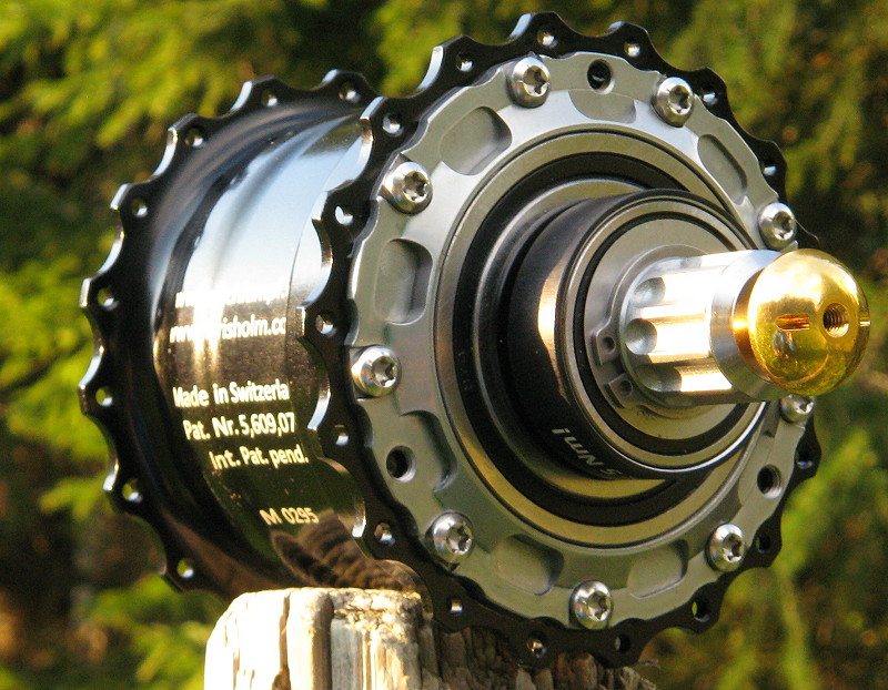

This seems like a major design flaw to me. Why can’t you use spacers, like we have on non-geared isis hubs?
Look at this pic and see why spacers should not be used…
Not sure what you are you referring to. The retaining clip? Or because the axle is too short to accommodate spacers, and therefore the cranks would not go on far enough and the shift buttons would then not be sticking out far enough?
Still seems like a fundamental design flaw that would cause the cranks to start contacting/rubbing against the frame, after tightening the cranks a number of times. And then after a certain point, as mentioned in an earlier post, the cranks would become loose after a time, because you could not tighten them any further, and would most likely require replacing.
As I understand it Jogi is using spacers (maybe just one) with his Triton to make the guni hub work with a disc brake. I intend to try using a spacer with my Schlumpf also, this time on my KH, for the disc brake as well.
Why do you think it won’t work? The button can be adjusted in or out, so that shouldn’t pose a problem.
I don’t think its a shift button issue. . . . . From what I can tell from my KH Schlumpf hub and the pic posted by Hugo, the regular KH ISIS spacers would bear directly aganst that circlip and are likely damage it or the groove it lives in - I don’t think many circlips in that size range that are designed to be loaded/pressed from the side- without bending/breaking and damaging the bearings held behind it.
