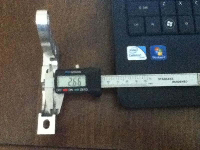

I did the same thing. It wasn’t from too loose bolts. I had to grind the bearing housing down just a hair so it could hold the knurled bearing snug enough.
Oh.
But that is not the problem in my case. There is still a millimeter space left between the two halfs of the housing.
Tolerance of new MountainUni.com part…

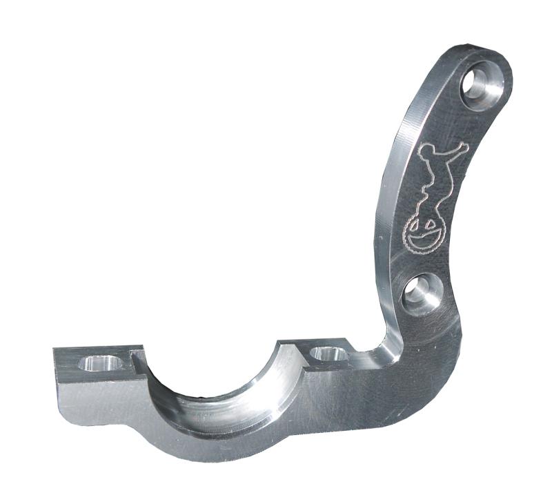

What do you guys think? I still don’t know if there is enough room for the lower bolt that will attach the disc brake caliper between the Uni-Caliper Mount and the hub shell, but this seems tight too! note the 2.85mm spacing behind the bearing and the part’s inner lip. I’m glad I’m not painting these! They are Made in USA, machined from 6061 billet!
Can you make those bearing caps quick release?
Yeah, yeah, folks poo-poo the “thneeed”, but for a disc brake set up that could use multiple wheels, it is a time saver and would prevent thread wear on the bearing holder bolts.
Seriously, I have a bunch or $$ burning a hole in my pocket, ready to pop for a guni, but I am on the fence when it comes to going disc hub or disc cranks on my exitsing rigs.
Assuming the Schlumpf is not going to be disc compatible in the near future, that makes a disc hubbed frame less appealing to me. If I could have one uni frame set and three wheels (26 x 3.8, 26 x 2.6 guni, 29 x 2.4) I’d be set.
This one thing would swing me.
I saw a design for a hinged cap on the other thread…
Quick release and the Schlumpf knurled bearing holder do not go together; the proper pressure is too specific. Too little and your high gear slips, dumping you on the ground; too much and you ruin your hub. No thanks on that one.
