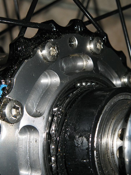

Steve, I have the same thing. I think I can see/feel the play happening in the large bearing (the one that was changed for a larger size in the recent redesign) on the side of the hub body. My rim knocks from side to side a couple of mm when holding the frame still.
Corbin - I think you said you had had the same thing, and saw mine do it at UNICON. I don’t remember if you got it fixed or worried about it? Roger thinks it may be a tolerance issue with the bearing size and could be fixed with a very fine shim, but that would require disassembling the hub.
Practically though, this may have been happening for most of the time I have had it and I’ve ridden this hub for a good 3000km. I’m not expecting it to fail suddenly on this.

Yeah, my KH36 with the older style hub has this problem too; the wheel knocks side to side. I think it is the bearings that have the slop in them that cause it. I’ll take a closer look and make sure it isn’t the bearing moving in the housing – that could be shimmed.

Also, when the wheel has play in the large bearings, they may have the old known problem although you don’t see it. The bearing has an outer and an inner plastic cap, to protect it from dirt. When I had the problem, the outer plastic ring popped out and I could see the balls and the destroyed bearing cage (or what was left over from it).
But if the black ring is still in place, the cage may be destroyed anyway with the result that the balls float around in a lose order, causing the play of the wheel as they may all be on just one side. It is possible to pop out the black ring manually, very carfully, and not fully, to have a look behind it. But of course on your own risk. But I think it is the only method to get a clear answer whether the bearing is OK or not.
I also did that on my new generation replacement hub, just to confirm that it was OK. I did that with a strong needle. As I said: VERY carefuly.

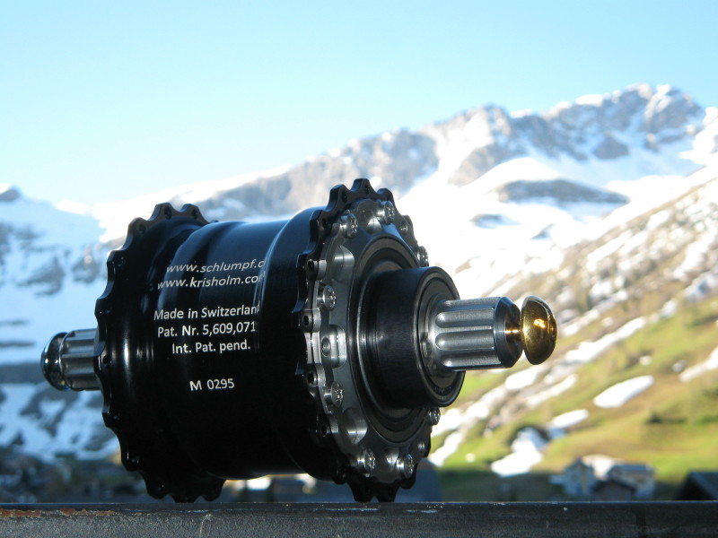

Hi there!
At last, I could build up my new (and first ever) Guni this week-end, after a pretty painful period of time where I had all the parts ready but no time at all to assemble them.
For those of you who are interested by the hardware mix:
My Guni is a KH26 with KH handlebar, Magura brake, and a KH/Schlumpf hub (#M0265 :)).
For now, I’ve put a Marathon Plus tire, because on Friday I will ride up to L’Alpe d’Huez (a famous sloppy road in the Alps) with it - but my goal is to fit the standard offroad KH26 tire after that.
I decided to start with 167mm long cranks, but am already pretty convinced that moving down to 150 will be a good deal overall.
I actually did my first test ride on Sunday morning… first time ever that I was riding a Guni - if you read this post, I’m sure you can imagine my emotion! :slight_smile:
The feeling is just great - absolutely different from a non-geared 26" or non-geared 36" uni. I’m not saying better, because I really love non-geared unis as well - but different. I love how this Guni becomes versatile, and I can’t wait putting it into the plane this Summer, instead of taking my non-geared 29" uni as I used to do.
I rode for a few kilometers in the valley, from home and mainly across the city, in high gear - and then decided to stop (yes… I did not practice yet the on-the-fly change of gears! :o) in order to switch down to the lower gear, as I had reached the start of a long climbing road (good for my training!).
Here, I realized that my left (silver) button was… missing! :astonished:
I decided to walk back on the very same itinerary, carefully looking for my beloved silver button… and (guess what?) I found it after around 20 minutes of walking: it was here laying on the ground waiting for me! :slight_smile:
I figured out that probably I should have put one drop of threadlock, in order to secure the 2 buttons in place - but had not done that and did not have any threadlock in my backpack anyway. I decided to continue my ride, but I would of course very carefully look at the buttons from time to time, and screw them in anytime either would tend to unscrew.

I parked my Guni, and when my working day was over, I went back to it… to discover that my (more beloved than ever) silver button was missing again!!! :angry:
I was pretty clear the button had left home again, but this time it was more hopeless to find it, with all the traffic, also the fact that quite a few hours had already spinned since I lost the part, etc.
Without surprise, I did not find the button yesterday - and this morning again I searched for it but failed to find it.
Call me the unlucky-lucky-unlucky-lucky man!
Lucky to be the happy owner of a Guni.
Unlucky to have lost the silver button during my first ride.
Lucky to have found it back on the road.
Unlucky to have lost it again during my 2nd ride.
:slight_smile:
Bottom line to this: I guess the use of a threadlock is almost required, right, to hold the Schlumpf buttons into position?
I have reached this morning Florian, in order to try buying from him a pair of Silver buttons and a pair of Gold buttons (just in case…), but his autoreply saying that they might not be very responsive these days does not give me too much hope that my Guni will be equipped with a Silver button soon…
I hope the same -bit ridiculous- story will not happen to one of you.
Cheers, MadC.
Did you tighten the little set screw in the middle of each button? By doing that, you fix the button to the shifting shaft that runs through the hub. It should stay there without thread lock. If you don’t, the button can easily unscrew due to riding vibrations and then fall of without notice.

Hi Klaas Bil
I am very pleased to hear what you are saying… because I never done anything like that for sure!
I have most probably been a victim of my over-over-enthusiasm in building my first Guni, and probably I just skipped the last instructions in the manual. :roll_eyes:
Shame on me - but the end of the story is pretty nice I think: at least, the hardware is not guilty!

This is the actual part of the manual which my eyes did not read:
Use a 2.0mm Allen wrench to firmly tighten the gear shift buttons. Use the little wrench that comes with every hub to hold the button against rotation. Check to make sure you cannot loosen the buttons by hand.
