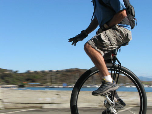

Here’s Mike on the v54:
I ride exactly the same uni, except it has a T7 touring handle :sunglasses: …
…in my dreams:(
That looks like a ridiculous amount of fun. :slight_smile:
