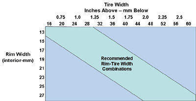

However would the 2.25" Nightrider tyre fit on this rim? Forgive my ignorance if this is a stupid question.
Mike
2.25" on 25mm inner width seems great
The chart covers it, but unless there was also news about a new tire arriving as well, I would expect that rim would be designed to accept the tires that are available now.

I have seen that chart before and wonder who really rides a 2.5 on a 25mm rim anymore. As far as I can tell it might be valid for mountain bikers who run pretty high pressures and want the lightest (skinniest) rims possible.
My own experience indicates that the ideal tire width to rim width ratio would be no more than 2:1. Any more than that and the tire needs to be pumped up uncomfortably hard to stay stable.
If you used these rims with current 36" tires you wouldn’t be able to air them down like on current unicycle rims. I figure if you are going to have to ride higher pressure, you might as well have a skinnier tire for lighter weight and more flickable feel.

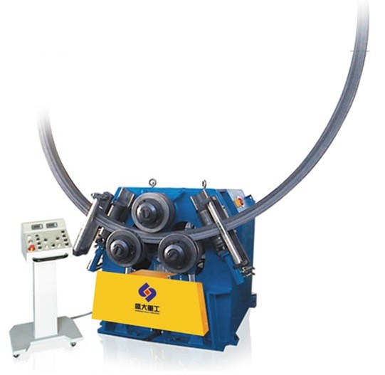

We’d need straight rim profile raw material and someone with a curving machine. Then it woult be possible to produce every diameter we want. In addition it would need a jig for boring the spoke holes and of course a thread rolling machine to produce custom length spokes. :slight_smile:
