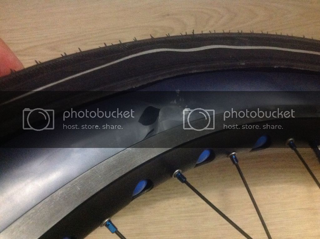

I was looking for road and XC tire (our XC is sand, small stones and small bushes). Stopped on Big Apple 29x2.35 on my KH Freeride rim.
Now some scary facts:
I bought Foss tube and installed with Big Apple in the evening (this was first time I got new Big Apple tire on) about 4AM it blows soooo loud. Took off tire from rim:
In the morning I was going for the ride so I replaced blown Foss tube with regular one and went. From then - everything is perfect.
Riding about 3Bar - it bouncing very good and rolling resistance is very low.
Love this tire!
Yeah- when mine blew off my rim with a foss tube it was so loud I thought someone shot a gun in the house!
