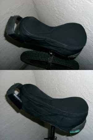

I tried a Reeder handle on my muni last year and I couldn’t get used to it. I actually tried three different Reeder handles, each of them was welded at a slightly different angle, and none of them were comfortable for me. I had problems with finger room and also with getting used to holding the seat handle at a slight angle. I’m used to the Miyata handle and I hold it squarely in front and not at an angle at all. I gave up on the Reeder handle. I liked it for climbing, but I couldn’t get used to it for general riding and jumping.
At the Moab Muni Fest Steve Howard gave me modified Kinport handle to try. It’s modified by routing out top of the handle to make it possible to wrap your fingers all the way around. I had problems with the stock Kinport handle because the ends of my fingers would get boxed up in that little confined space. The modified handle is absolutely great. I love it. It’s strong and there is no flex when I push and pull on the handle while climbing. It will also fit either hand equally well so there is no need to make a decision about whether you want a left hand or right hand version. The bottom edge of the finger hold is square and angular so I slit a short piece if vinyl tubing and taped in under the handle. The vinyl tubing rounds out the bottom of the finger hold and makes it very comfortable.
You could modify a Kinport handle yourself by cutting away the plastic at the top. Mine came from Steve already modified so I don’t know what would be necessary to cut the plastic. Here is a thread where U-Turn (Dave Stockton) explains how he modified his Kinport handle.
<http://www.unicyclist.com/forums/showthread.php?s=&threadid=22333>
The Kinport handle with extra finger room is now my handle of choice for muni.
I’ll attach a picture of my muni seat with the modified Kinport handle. You may also be able to see in the picture how I’ve taped up the vinyl tubing one the underside of the handle, but the photos don’t show that very well.
I should have linked to the Kinport handle on unicycle.com. Here it is
<http://www.unicycle.com/shopping/shopexd.asp?id=609>
OK, here’s a picture of the underside of the handle. You can better see how I slit the vinyl tubing and taped on under the handle. The vinyl tubing rounds off the edges and makes it quite comfortable to grab.
