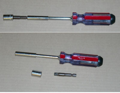

I use a screwdriver with removable tips. I’ve fitted a socket attachment on it. It will fit in the tight places where a standard socket wrench won’t. Although I have not tried this tool on a KH that has the brake mount welded on the seatpost. I’ll attach a pic of the tool.
