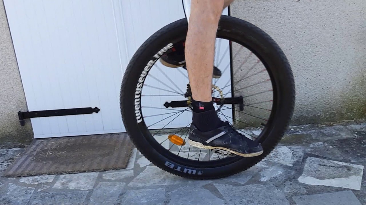

Gap between hub and cranks has been reduced on latest production to refuse creaking
Could it be the same issue as
and
A good answer is
Sorry for the :france: :baguette_bread: :wine_glass:

Really? is that the sound of the cranks? To me that always sounds like the spokes. As if the whole wheel is about to collapse at any moment…
