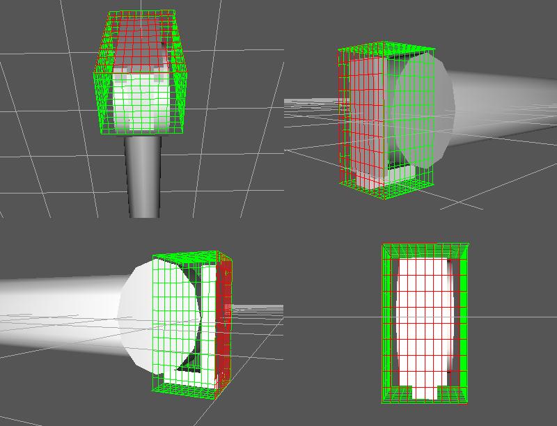

How would that work Bevan? I am a bit confused… Would you then hinge the frame? or hinge the QR outwards? I think my ide would work in theory, but just wouldn’t be able to be both strong enough to hold up, and yet not in the way. But I could be wrong, my idea could work. I just don’t see why we can’t just put a willte effort into it and unscrew the bearing holders if we need to switch the wheel. I mean… it takes less than 5 minutes to do.

I made a 3D Design to firther clarify my idea, and to help point out design flaws(there has to be something). If you could get a semi-strong matertial, like steel or something, that could hold up to most abuse without denting in(beyond repair) or making the clamp suceptable to injury I don’t see why this couldn’t be used for converting a muni to a cruiser and visa versa. I am sure it isn’t the greates idea for street and trials where the bearing clamp will be constantly abused with grabs,and what-not, but Why not just use it for uni’s that aren’t going to be destroying the bearing clamp.
open face
solid cover-peice

By the time you’ve screwed on that cover or removed it, you’d have gotten normal bearing caps off.

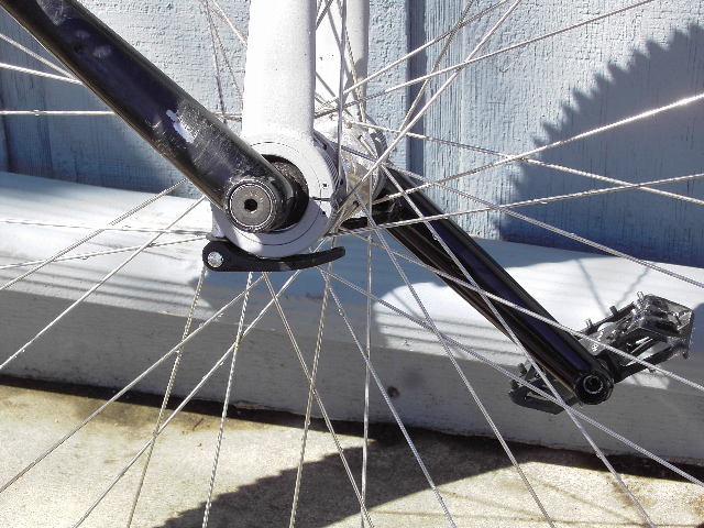

I don’t see any need to design a cover or other protective piece for the quick release lever. As long as the uni isn’t used for pedal grabs and crank grabs it will be fine. It would be perfectly fine for the way I ride my muni. Even in cases where I slip off the side of a skinny it would be very very unlikely to break the lever even if I did hit it on something on the way down.
My concern would be accidental opening due to vibration or hard impulse force (landing a big drop). There isn’t a lot of clamping force on the bearing housing. If there is too much clamping force you will bind the bearing. So there isn’t going to be a lot of back force on the quick release to prevent accidental opening due to vibration or impulse force. This would mostly depend on the shape of the cam that the quick release uses. If the QR used here has a tendency to pop open it might be necessary to file a small flat area on the cam to get it to lock in place when closed.

I thought I would bump this thread with a picture of the QR on the frame. We have just put together a couple of prototypes to test out. So far the QR bearing holder works like I expected. It takes less than 30 seconds, and no tools, to completely swap out a wheel set, and that was the 2nd time I tried it. Right now we have a modified Yuni frame that I’m using for my Beast 29er and two prototypes that Owen and Nate are working on. Everyone is welcome to check out the real thing at Moab.
That looks awesome. Do you have to fiddle with the quick release lever to get the right tension on the bearings?

I was a bit worried about that, but it turns out that the tightness is in the right range within one revolution of the lever, so you can do it on-the-fly. Also, I found that once you adjust the bolt (it’s continous since it’s got a barrel nut) it stays in that spot during the change over, so it ends up just right.
