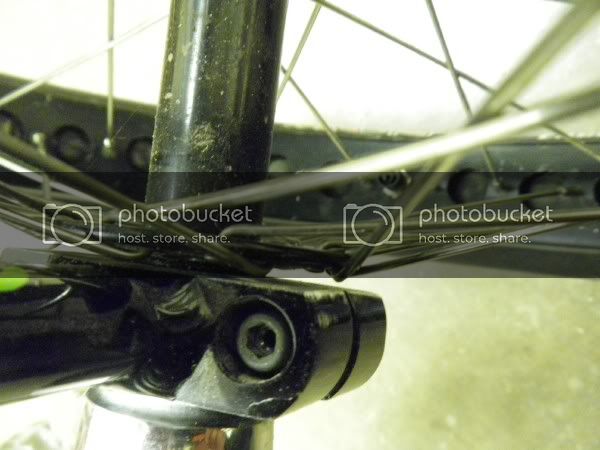

I sold Pele my Alien Backflip frame… He made it fit on a nimbus hub and i believe Koxx One and Qu Ax have the same bearing holders. It just took a ton of time and a metal shaving file. All he did was shave down the bearing holders on the inside of the frame on both forks
I have also made a frame that “doesn’t fit” fit. It just took a long time on a belt sander and I was able to fit a Nimbus hub in an Alien Backflip frame
I had to do the same thing with my alien backflip frame in a kh hub.
If it doesn’t fit, you can make it fit ![]()
