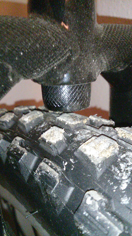

It has arrived earlier today and for sure I tried it :D:D . The inseam wasn’t the biggest problem but I am sure now that 33" inseam is the lowest this unicycle can go without shortening the seat post and I attached a picture showing the clearance between the seat post and the tire and by measuring it I found 5mm (0.2in) to be the separation at this point. I am going to shorten the post in the future because I don’t feel safe driving like this.

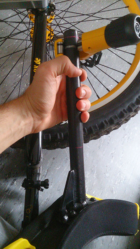

I attached some of the process pictures. The pipe cutter is a Rems Cu-INOX 3-35mm which cost about 31 eur inclusive shipping. The device feels like Snap-on quality but cheaper for sure.
