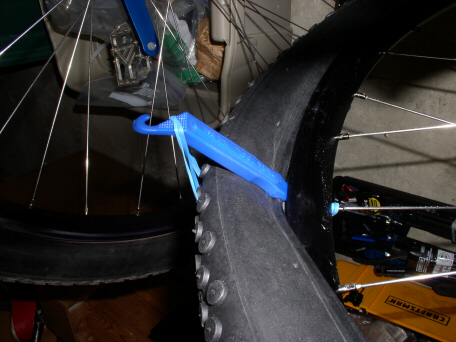

It’s normal but not necessary. I do it solo with two plastic levers and a rubber band. I’ve been meaning to put a FAQ together but have been too busy. Basically you have to keep the bead in the center channel which has a much smaller diameter. At the end hold one lever on with the rubber band, and use your hands and the other lever to leverage on the rest of the tire. I’ll get the pics and text up as soon as I can.

Here are a couple of photos that show the rubber-band trick that lets you do it solo. The rubber band is a fairly long heavy-duty one that I got at the local hardware store. In addition, the plastic levers are Park brand and are very stiff (but still plastic).
Here’s a back view of the trick.
