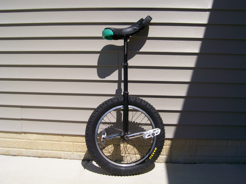

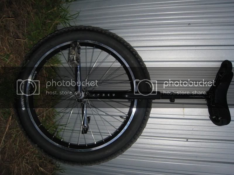

Anyone care to post pics of their setup? Would be great to see some of these again, I’m a little tired of seeing just KH Moments all the time :roll_eyes: !
Old pics of Hugo’s ride his old ride: Street pictures thread. - #7 by extremtrialist
And the 3 next pictures here:Webshots - Wallpaper / Screen Savers
http://www.unicyclist.com/forums/attachment.php?attachmentid=21750&stc=1&d=1187479851
2 last pictures are from 2003.
EDIT: I couldn’t find a picture from Timbob1907’s brother unicycle which was a Bedford Hardcore with a KH 07 rim powder coated red. It’s one of the best looking unicycle I’ve seen.
I’m planning on getting a KH’10 rim powdercoated in red in time for the Profile wheel. This time black hub with the new super hollow GDH spindle. A first for the unicycle hub!
Reminiscent of the old red DX32 Profile set up Zack ran in Defect, man I loved that colour scheme.
Nice unis by the way!
Oldschool eh? Whatever :wink:
