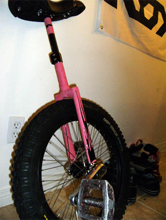

Is that camouflage? That’s awesome. How did you do it?

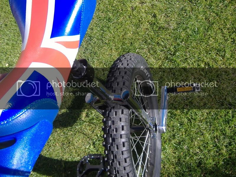

the new beast…
starting to ride a new style these days.
after seeing a movie called “Crux”, ryan leech video. I kinda wanted a change. so im starting up with trials again but adding a manifesto/ street style to it.
p.s. im really impressed with the nimbus…

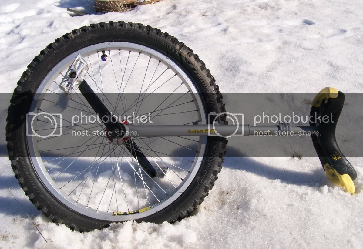

There’s my unicycle and my dog =) shaved the tire yesterday and today, its really good, and i like it gotta sand it a bit more, but im tired
Edit: sorry it’s extremely big
