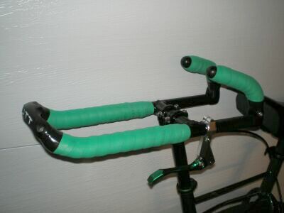

Heres the first set of bars I had on Florian Green. The intent was to have close grips for mounting and slow speeds, as well as multiple forward positions for speed work.
I tried out unisk8r’s handlebars above. I agree that having something to grab on to closer to the seat would be nice. Especially for hill climbing. The draw back with these bars is that they are a little bit wide, and my thighs ended up banging into the ends. I’ve toyed with mounting those bar end grips on the existing handlebars (see above post from 12/11/08) so that I could grab a little closer to the seat. It would require welding some mounts. But I’ve found that if I grab on to the joint between the aero bar and the “T” stem (right where the brake is mounted) then that’s close enough. I’m not sure if the bar end grips would be worth their extra weight. If I didn’t have to weld mounts then I’m sure I would have found out by now.
After trying several different configurations I’ve settled on the configuration from the 12/11/08 post. I’m pretty happy with them as they are right now.

That’s sweet! do you you have more pictures? I may want to replicate that style. What is it made of? Where did you get the pieces from?
corbin
That is exactly why I added the “power grips” to my handlebar.

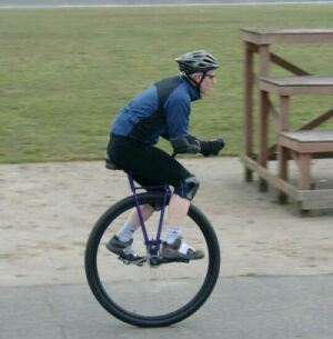

corbin: those are just cut-up pieces of 7/8" alloy drop handlebars, re-welded (by TIG) into the shapes and lengths I wanted to try.
brycer1968: I have tried mounting elbow aero pads (the folding type that fold up when not in use). They make it more difficult to ride, because your hand input is “diffused” by the weight on your arms. I think with alot of practice (no worse than anything else in unicycling) the aero pads would be useful for road rides, but that would involve learning to input on the bars with your whole arms, not just your hands. Hands alone allow more defined and subtle inputs on the handlebars. Hope that explanation helps!

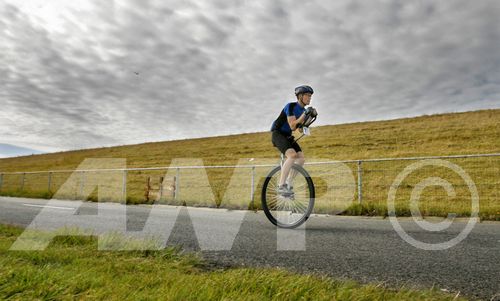

This has been posted before - me in my 2005 “tuck”:
Compare my “tuck” position to someone like Dustin Schaap’s more vertical bars:
