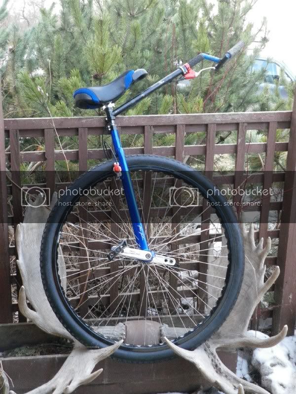

Nice Bull Horn! :stuck_out_tongue:
How much does it weigh?
Looks about right to me, but I like stretching out in front.
It goes another 6" longer if I want, but the brake line is too short.
FTFY, sorry pet peeve.
just spent half an hour looking for my scale. Looks like 8.78 kg or 19.4 lbs
Not too bad I guess, especially for a 48 spoke wheel Moments and a long steel handle. My next heaviest unicycle is the geared 24 which weighs in at 7.18 kg. Man I am starting to sound like a weight weenie. :stuck_out_tongue:
I am starting to get back into the road riding thing. I will have to get used to the 36 again then I think I will throw the bike seat on.
Why the 48 hole set up? Strange choice for a weight weenie :slight_smile:
Sam
Some things are worth the weight.
I wanted a MUniable 36 with a regular width hub. 48 is the way to go if you want both a stiff wheel and a skinny hub.
I did drill the outer wall of the rim. I can’t remember the weight savings but it was about equal to 12 spokes. Even with the rim drilled it is heavier than a 36 spoke wheel but the weight is more in the middle of the wheel and it should still be stronger.
I still get a bit of brake rub on the rough stuff but not too bad. Going to go with a disk as soon as I can to fix that.

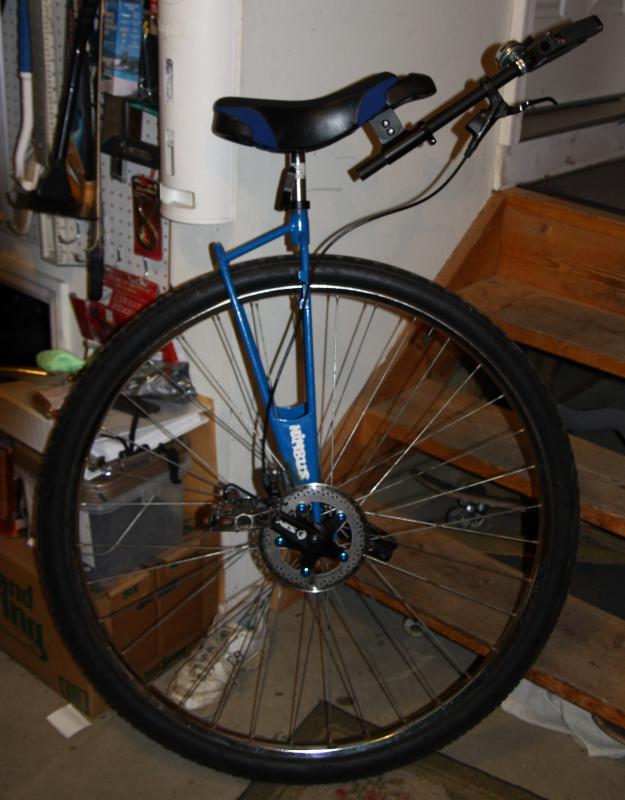

my finished mountainuni 36’er
specs:
kris holm freeride saddle
sinz double drilled 152/125 cranks
mountainuni disc brake
avid juicy 3 caliper
kris holm touring handle
coker tire
nimbus double wide square taper hub
nimbus nightrider square taper frame

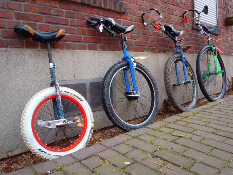

Posted this picture before but couldn’t resist to show my ā€˜family’ again.
(Perhaps a new thread?!)
One family but all different characters by the way!
nice one, James.
its, beautiful… sniff
That’s one nice family you got there! How wide are your handle bars on you 36er and 29er? they look really wide!
Really nice uni’s tr4nspo! I want your guni!
And what is in the spokes of your 29er?
