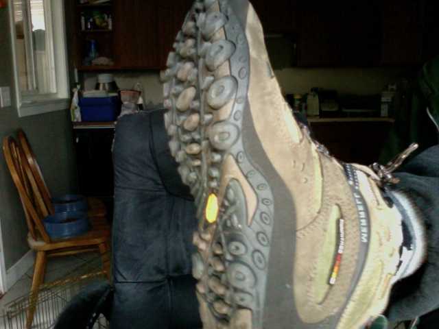

I have some similar Timberland shoes with major knobs like that which I love for my MTB/BMX. Just in the forefoot its flared out a bit so its a wider base. Makes it hard to place my foot without knocking the cranks with the knobs.
I am less concerned about hurting others, just myself for now. For now I’m doing cruising and learning a few tricks but not so fast that I’ll be doing all these flat tricks where I’ll be spinning the uni around a lot. I wish I were lol. :o

I’ll check out those shoes and the new guy at work his when he wears them as hes into BMX. I think I need bigger holes and/or knobs on my shoes now. I have mid tops. I might try those too or just switch pedals, least for now til April showers ends which I hope is soon lol. Otherwise I might have to build an arc lol.

Should I just cut the knobs that flair inward at the ball of the foot to give me more clearance so they are just flush with the bottom of the sole up front? They kinda flair out at a 45 degree angle. I think then my trail shoes would work good for now.

But the guy there that is into BMX swears by the Lotek shoes with volcanized sole. The GOOD news is that if it IS a BMX or MTB shoe, I can afford a decent pair of shoes from one of their distributors as I just won a $100 credit for goods for selling more then anyone else in the other 5 stores. :smiley: They also have specialized rockhopper shoes with major knobs and not much of a plastic piece for clip ins, but that guy said I needed lots of close groves for the pins to go in for most grip. So I guess that seems best. Open to comments/suggestions/contraindications, etc. Anyway, this is a pic I found of the sole of the Lotek shoe he suggested. And I will have money for this soon and I can order it through work discounted. I will check later on 5-10 shoes but doubt I can get those through work.
I sell those timberlands at my work, and although the stiffness isn’t too bad, they don’t really have any other qualities that would be nice for uni in my opinion. Plus they have goretex which gets bloody hot, my fivetens are hot enough, I don’t need goretex to add to that.

I like the beefy knobs for trails/dirt as its good traction but my main concern is grip to the pedals. I know it wont rain forever, but unicycling is my only cost and time effective sport I do when its wet weather out so I want to make this feasible and safe. We are having 10 days straight of rain and I’m sure this wont be the last time this happens.
So is the 5-10 my only good option? How are those knobs more effective then others or is it also the rubber compound? I want to understand this. Seems like better pedals would have to be the harsh metal pin ones and those are killers on the shins. So prefer my light/easy on shin plastic ones if possible.
The rockhopper shoes at work are similar to this, but this is almost like my timberlands. I was told the knobs are too far apart.
