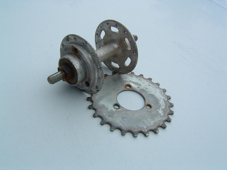

I bought a 2nd generation (bolt-on hub) Schwinn Giraffe that needs work. The tire was shot and it of course is Schwinn’s proprietary style tire. By that I mean only Schwinn style tires mate properly to Schwinn rims. The rim is rusted too much cosmetically so I decided to go with a different rim and tire altogether. Tom Miller (The Unicycle Factory) sold me a chrome 28 spoke rim compatible with the 28 spoke giraffe hub. He also hooked me up with chrome spokes and nipples. I asked if he would teach me how to build a wheel and he obliged.
First I disassembled the original wheel and took pictures of the hub and bolt on sprocket. They looked nasty so I used Tom’s buffing wheel to clean them both. See the pics below to see the difference with the hub!
Next Tom showed me how to assemble the wheel but I relied on his expertise to true it. There’s a lot to truing a wheel!
The next day I aquired rim tape, a tube, and a tire of my liking. I’ll be putting it together later tonight. For now, please enjoy the teaser pics of how well the hub cleaned up. More to come…

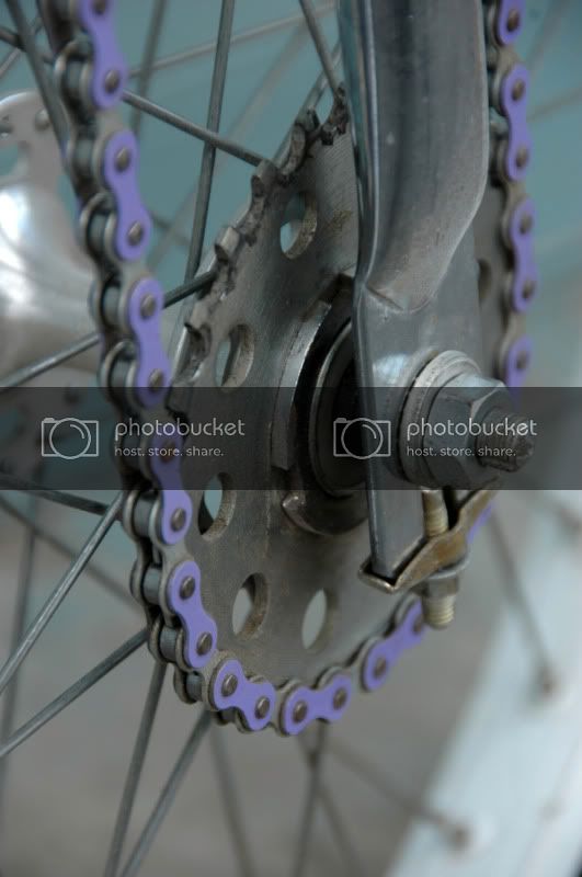

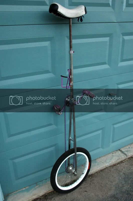

Wo… look what I found on Craigslist:
$200 and it’s now mine.
Still has the Giraffe sticker (under drink holder) And how about that groovey puple chain/pedals/ bottle holder!?
The serial # starts with 77. that is 1977 model yes? Is this the right hub set-up for that year…it’s different than my other. Seller told me it was custom.
I like the white wheel rim.

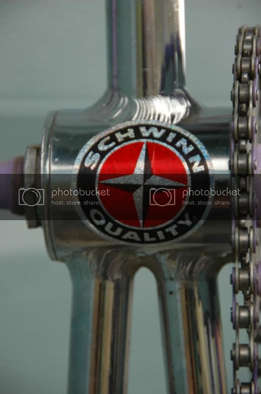

Schwinn Quality! (stock sticker??)
I changed out that weird Miyata seat, and pedals for now. But the quest for pimpage is back! I’m thinkinhg taking it back to it’s original parts. White-walls and all…? WWUD?
Anyway I am happy guy today…whodda thunk, Craigslist…wow.
I wonder if you can reach the water bottle cage when you’re sitting on the saddle of that thing. Maybe you’re just supposed to get a drink on the way up when you’re freemounting.
Great news Bondo! Yes the first 2 digits indicate the year of manufacture. Therefore you own a first year Schwinn Giraffe. (They were made from 77-83.) Yes that is the correct hub (track hub) for that year. That makes it a first generation hub. My hub is the 2nd generation bolt-on hub.

I would suggest disassembling your lock ring on the hub, cleaning it, then re-installing it with medium grade locktite.
