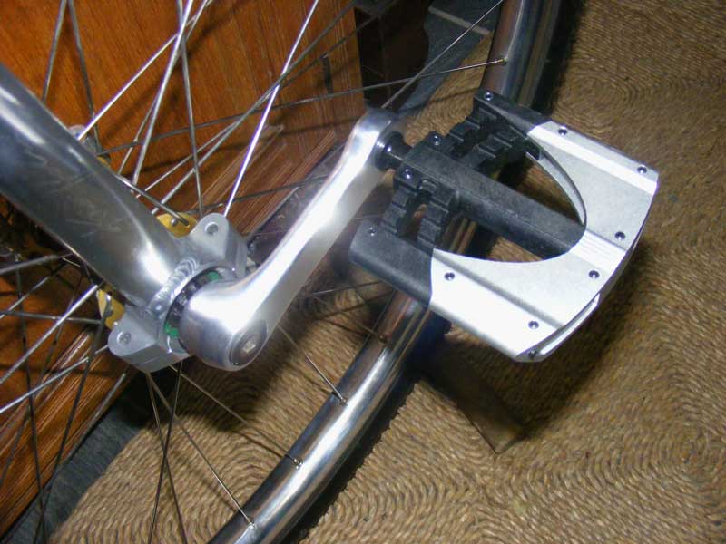

I just bought the silver and black version of these… Not sure if they will work because the spindle seems to protrude a long was out of the crank (red black pedal pic)
This could mean the pedal is pushed out further and might equate to the equivalent of having a Q factor on the crank, when I prefer to ride without any Q factor. We shall see.
I was concerned that the new pedals I ordered may protrude out of the crank too far. Because the pedal spindle looked quite long and I thought it could introduce, in effect, a Q factor even with zero Q on the cranks.

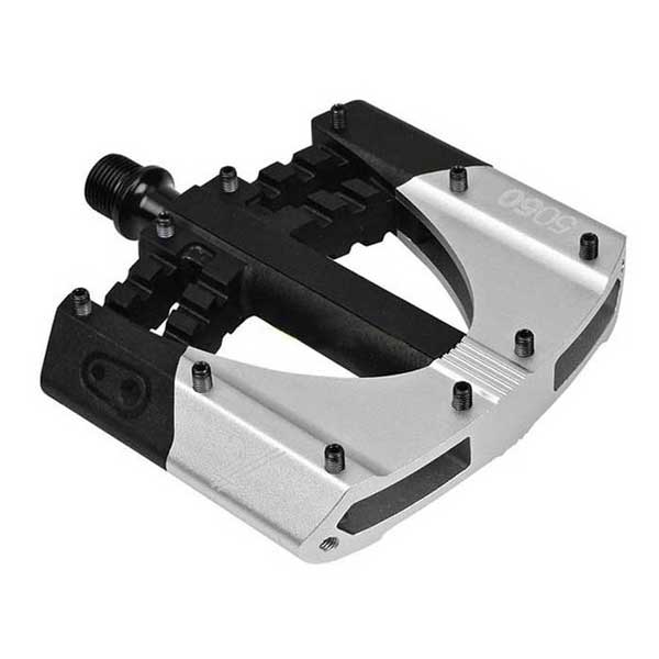

(pics) Pedals are packaged attractively but are the most expensive I have ever bought. Adjustable pins to ‘dial-in’ the amount of foot movement.

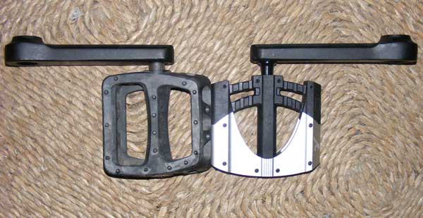

So, I have compared the new pedals against plastic ones that I ride with. The photo shows the new pedal does protrude further from the crank than my plastic pedal. the spindle is about 5mm longer on the new pedal.
I’m not sure what the Q factor measurement is in millimeters on a crank, compared to a zero Q factor crank. Does anybody have advice? Whether I could percieve the difference as I ride remains to be assessed.

There won’t be any difference. Since you can ride with your foot rubbing the crank in either case the q stays the same. If your foot was secured to the pedal it may have some effect on the tread, which could add virtual q.
I think this gets to the heart of why Q Factor is defined as the distance from the pedal mount on one crank to the pedal mount on the other crank. It’s the overall gap that’s important, and not just the crank offset. Since there are a variety of things that effect the Q factor it is simplistic to assign the value to crank offset alone. It kind of works for uni’s since our spindle length is not too variable.
Fwiw an ultimate wheel is the closest you can get to truly zero Q. My UW has a Q Factor of 18mm’s. By comparison my “zero Q” Ventures have a Q Factor of 180mm’s.
