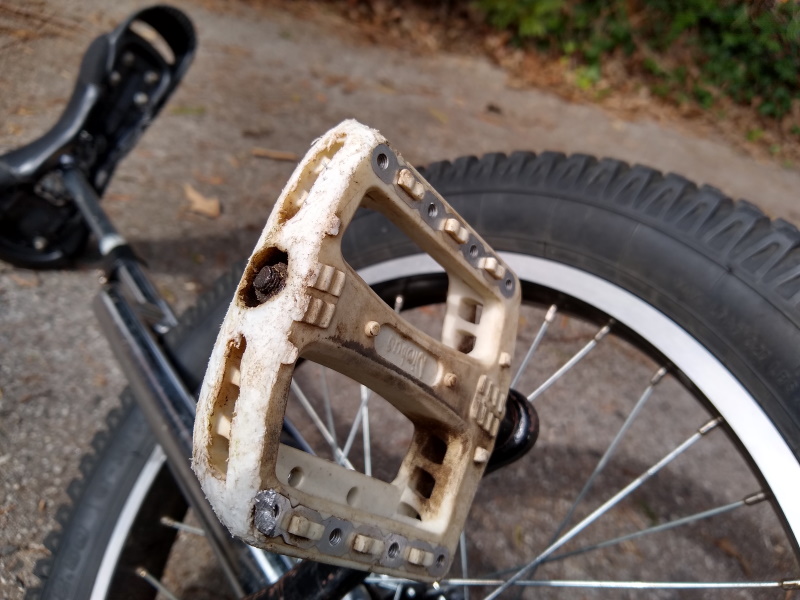

Beginner pedals…
Those aren’t in bad shape by my standards. Here’s what the ones on my casual-practice uni look like. The corners are so far gone that the metal inserts are getting chewed up, the place at the end of the axle has lost so much that the axle itself is starting to wear… but they still work fine!
