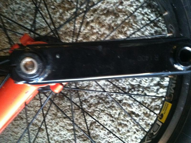

I have some pictures to see if this helps. I am not sure what the different cranks are or look like. I know these are 140 but thats about it. I took them off and flipped it around to see if that works and the pedals do not want to go in easy still. Its not the pedals because I took them right off my KH 26 inch muni (same model year as this). The pedals go in easy and straight on the muni but not on the trials even after I flipped it. I have no problem buying new cranks I just want to make sure they are the right kind. Thanks again for all the help and advice!
Oh, yes, those are the very old 8-splined ones. I’m not sure you’ll find any of those anywhere.
You could get a new hub and cranks and rebuild the wheel. I realize it would be a lot more work than just switching out cranks.

Okay… Well… Turns out who ever assembled my unicycle 9 years ago put the cranks on the wrong side! I have no idea how I never noticed this but I just flipped the cranks around put them on the right side and now they are working fine. Thanks for all the help everyone! You have now made me realize just how old and out of date my trials unicycle actually is ha.
