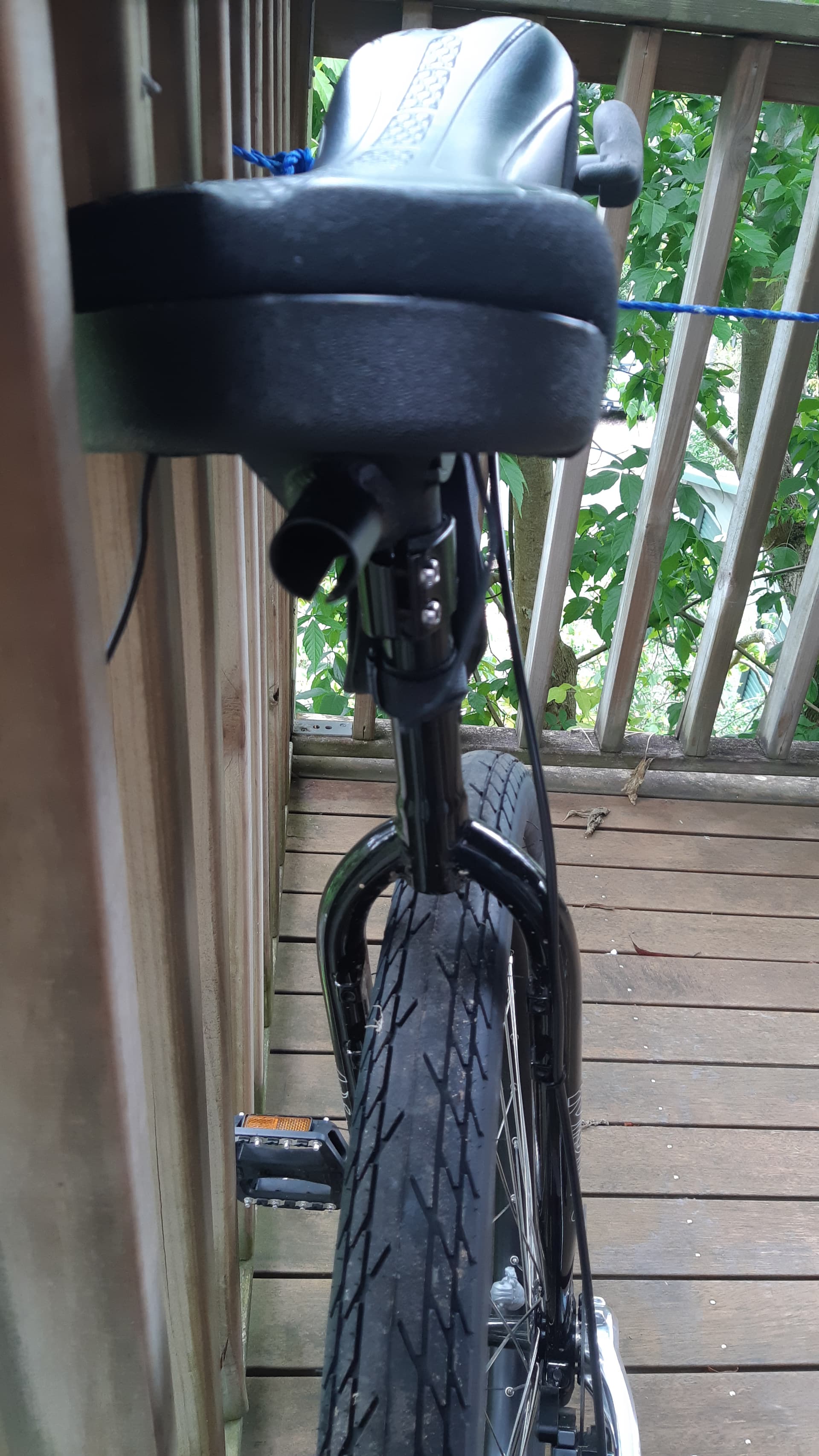

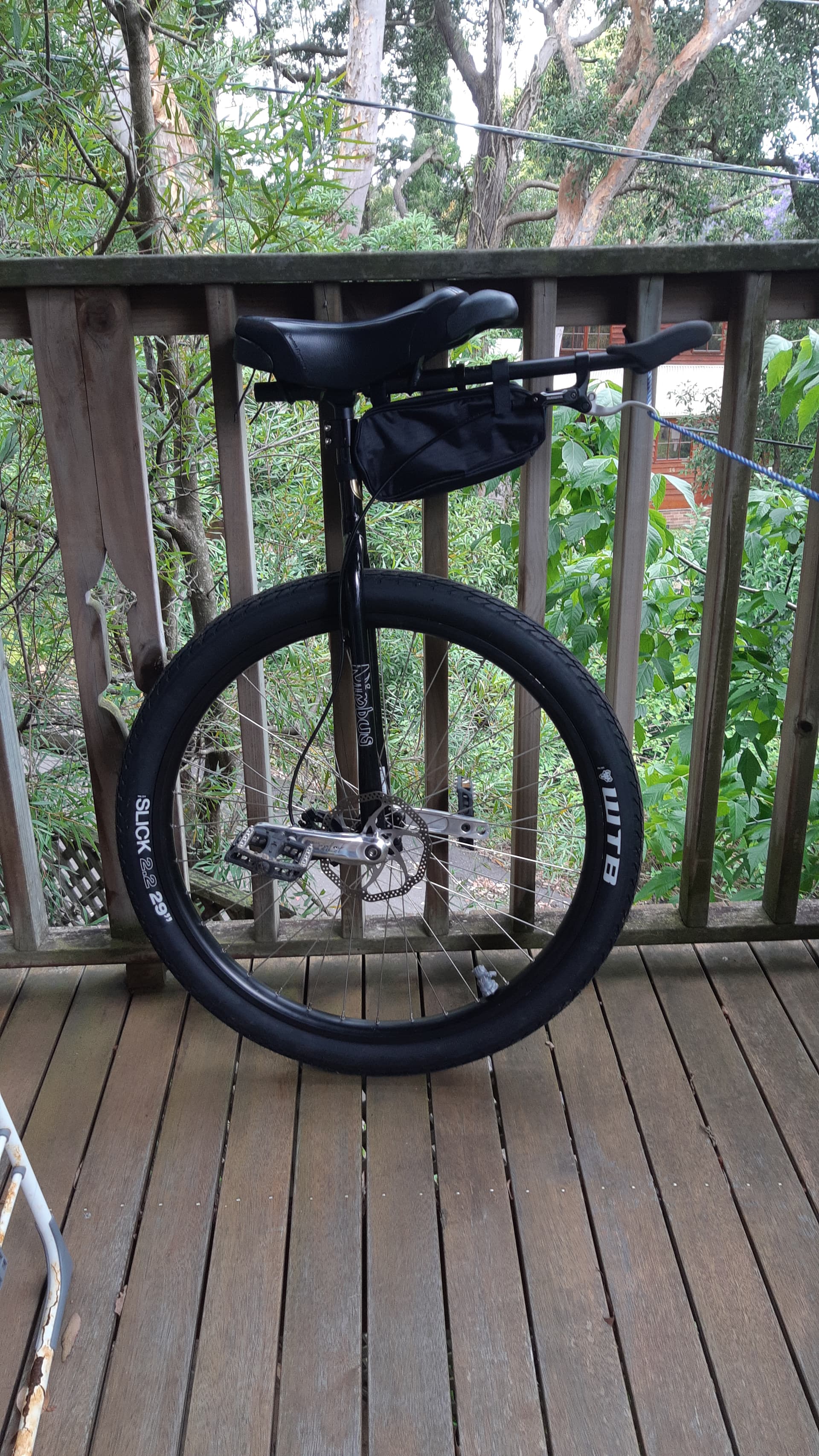

Thorofareken posted on this forum about the WTB Slick 29" 2.2 tyre. I just put it on my uni and I like it. Pretty close to effortless pedalling on flat ground. Feels very nimble. If it wasn’t for needing to go up hills I’d even go with shorter cranks I reckon (Current setting 127mm). First 7 or 8 times I tried to stop and hop, it worked. I didn’t ride in any place with massive camber, but in the areas with camber, I didn’t notice it.
Previously I had a Maxxis hookworm tyre on it which was pretty good and Schwalbe Big Apple (I didn’t like it at all, always felt the camber).
Nice! How does it compare with the Hookworm? It must be much lighter for a start as the Hookworm is such a weight monster…
