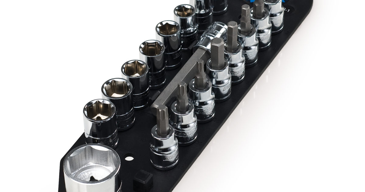

For the torque settings i use this
This has the correct sizes for most of the uni bits and the socket for crank pullers as well.
