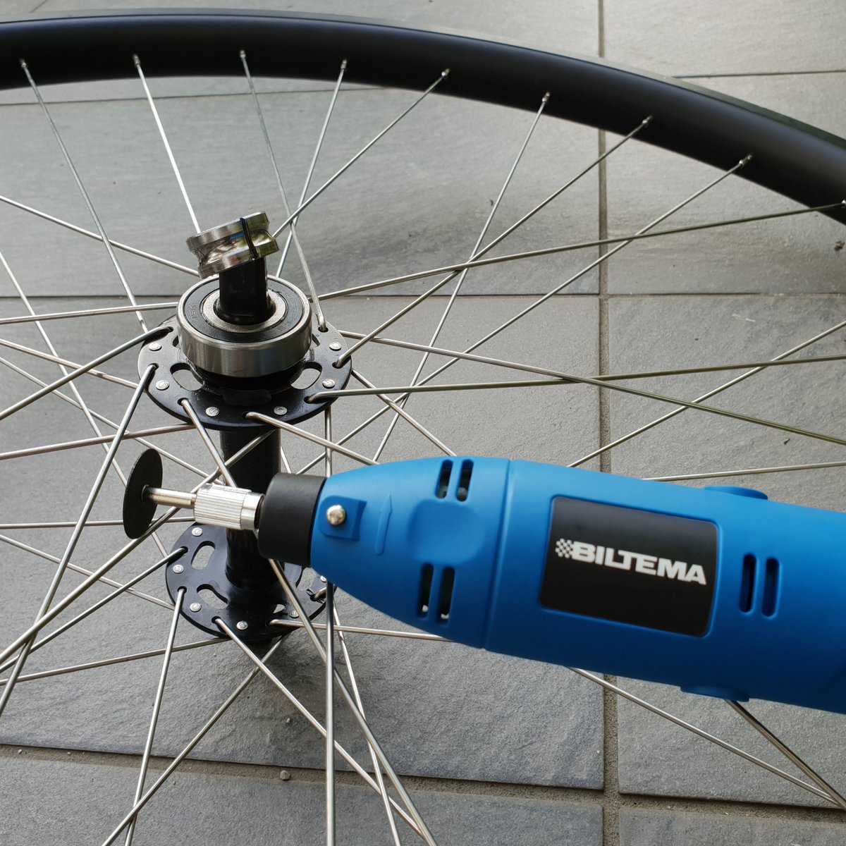

However, because the bearing casing is so completely broken, attempting to remove the broken bearings just resulted in the bearing breaking down further, leaving only the inner ring attached. The nimbus bearing puller cannot now fully get a grip on this inner ring. Only the absolute edges can contact the inner ring and attempting to extract is just resulting in damaging the bearing puller (the edged start to bend). So I am now well and truly stuck. I cannot remove the inner ring and I have probably damaged my bearing puller. What now?
if you have a dremel tool, or a small hand held motor tool you can use a cutoff wheel to slot the inner race of the bearing. I would go slowly, and stop before you go through all of the way to protect the spindle. once you get a slot into the race you should be able use a cold chisel, or maybe even a straght screwdriver to break it open, and then it should be easy to pull off. If it is still difficult you may need to make a second slot.
I don’t but I have a friend who would (currently on holiday). I shall update when i have tried this.

We have a winner! Finally got around to meeting up with my friend, who had such a tool
Super neat!
