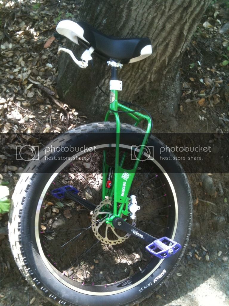

I have a Nimbus Oregon unicycle from the first “edition.” It has not been ridden very much since I have had it. I just never felt very lovable towards the ride. I can send pictures if interested. I’m in the SF Bay Area (San Jose). Prefer pickup, but will ship at your expense. Asking $485.00. You can text or call (text is easier) 408 205-9 one one 6. :slight_smile:
What size wheel?
This is the 26" wheel. It’s like riding a 29" because of the fatness of the tire. This picture is mine from when it was new. It has a fatter tire now, also the white is a bit dirty from drops in the dirt.

Don’t worry too much about the self-steer, the Oregon pictured here has a Surly Larry tire that is prone to self-steer. If you go with a more recent tire, you should not get that much self-steer (but with a 4.0 tire, you have to show the uni who’s the boss anyway :stuck_out_tongue: ).
