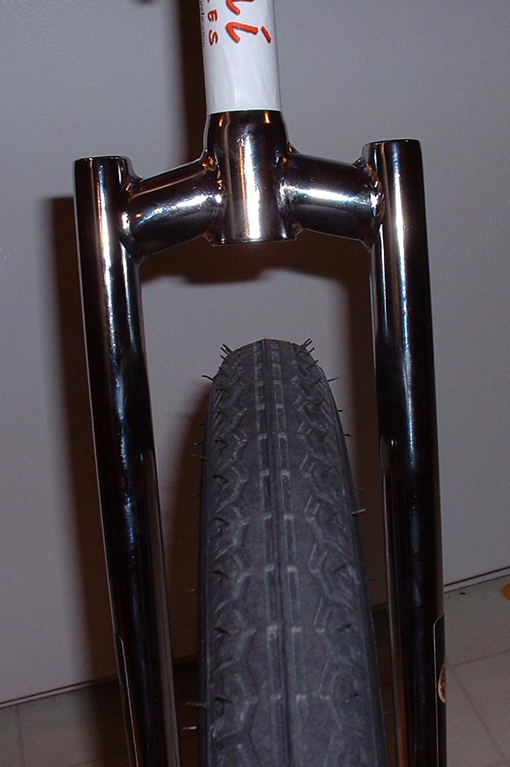

Here’s my kid’s new Yuni/Nimbus II frame with a Torker wheel and tire installed. Lots of clearance.
Mojoe
jee’z,who’s putting the stickers on those in such a hurry?
hi phil,
your frame definatly is a bit on the short side, if it catches stones then thats not good. it can even cause faceplants when offroad. get back in touch with roger, he might be able to exchange it if you ask nicely.
from what i’ve seen nimbus ii / Yuni frames certainly do have a bit of variation in them,
the clearance on my nimbus II /onzatyre/montyrim/profilehub trials uni is just over one inch the rims should be the same diameter or the tyres wouldn’t be interchangable.
perhaps you could find someone with a freestyle nimbus ii who’d like to swap frames.
when i decided on my freestyle unicycle frame i went for the sem xl wide frame. because my nimbuss i was realy big.
if unicycle.com/.uk.com graded the frames and used the smaller ones for freestyle unicycles and the larger ones for trials then everybody would be happy.
mine is actualy a bit lop sided. but it dosen’t make any diference to ridability.
LOL,i’d love to see the machine that squirts those frames out :slight_smile:
