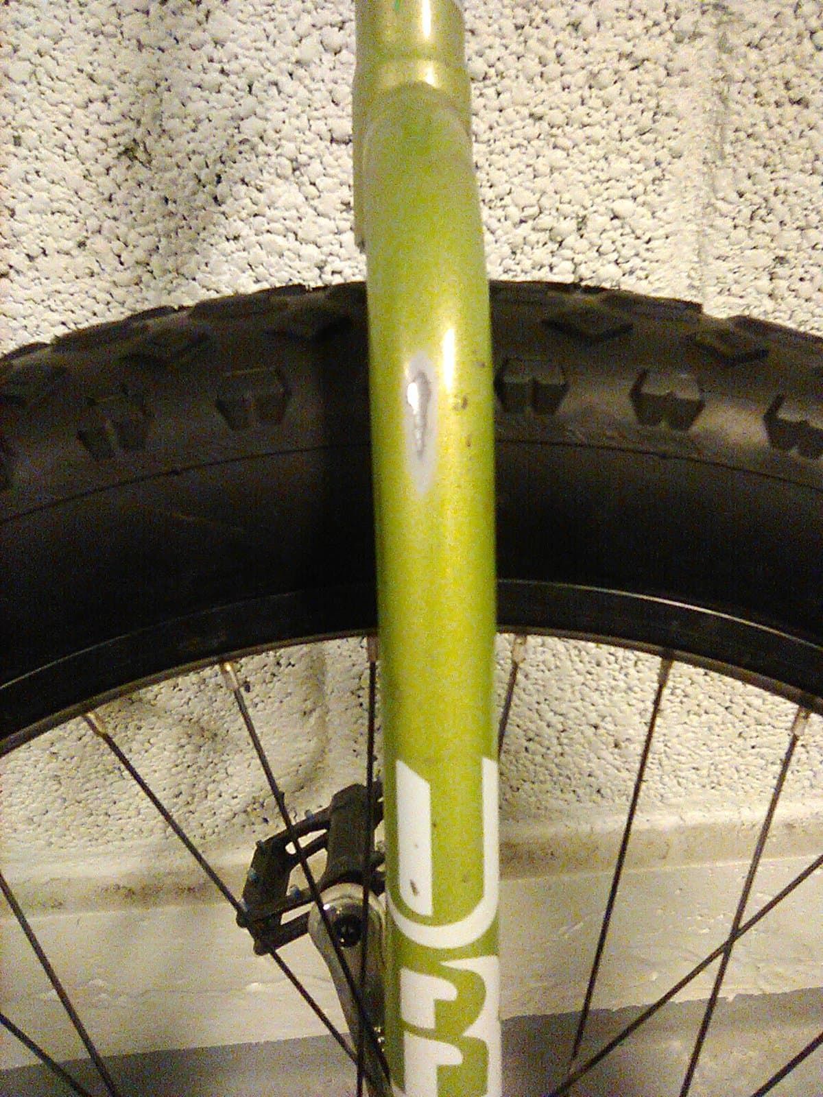

One thing I failed to mention so far is that with a tire this fat leg rubbing happens regularly. The hatchet frame design manages to prevent rubbing against the frame, but with a tire that wide it’s difficult to avoid rubbing against the tire from time to time. It’s much more noticeable than on a slimmer uni.

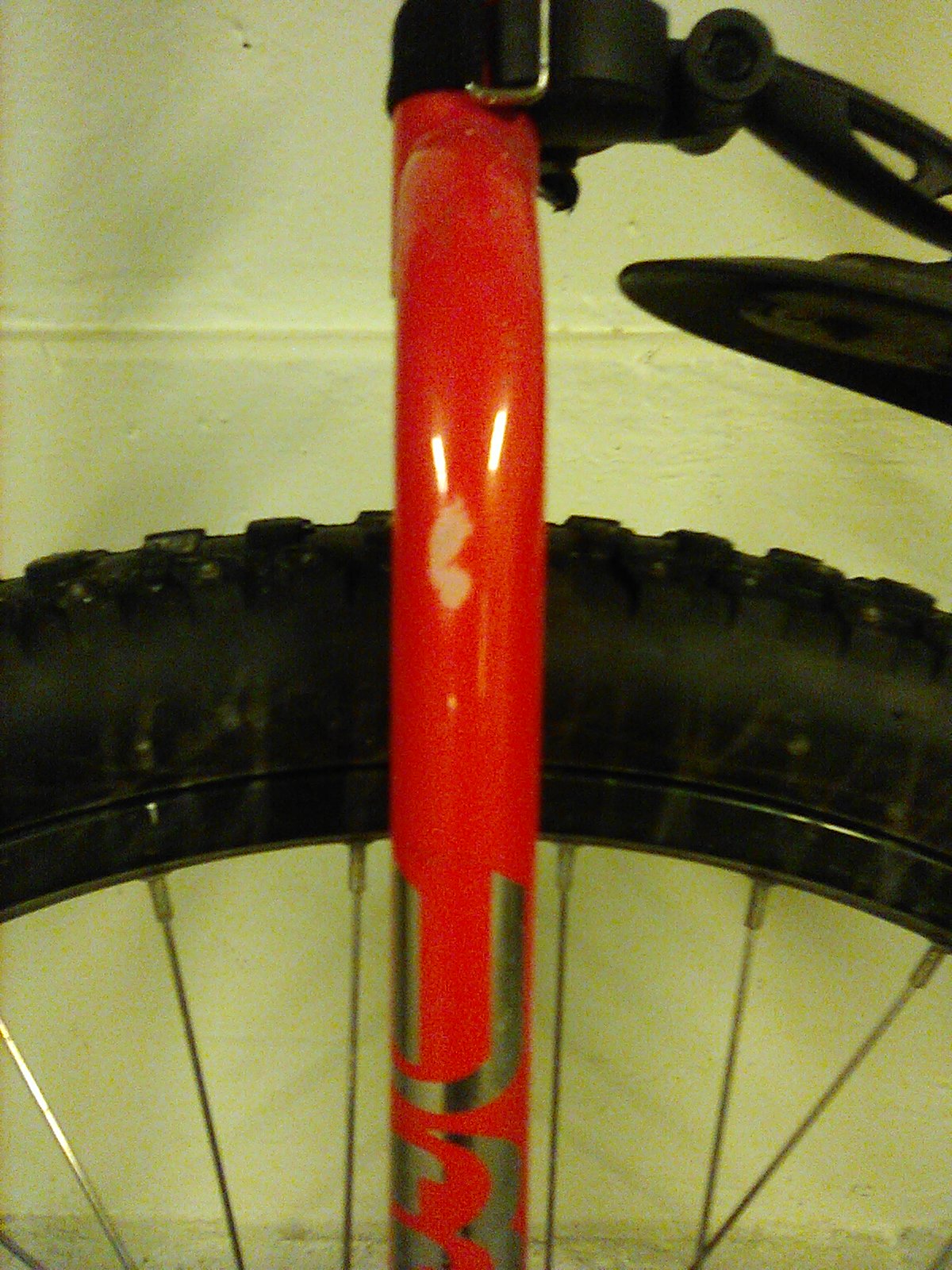

Ha… I can relate. My two URC frames
That’s the same with my Fatty fork. The first 2 or 3 trips I was still bothered by it. On the other hand, the contact also gives some guidance for the legs. I have absolutely no problem and once a year there is a bit of silver spray on the affected areas :slight_smile:
