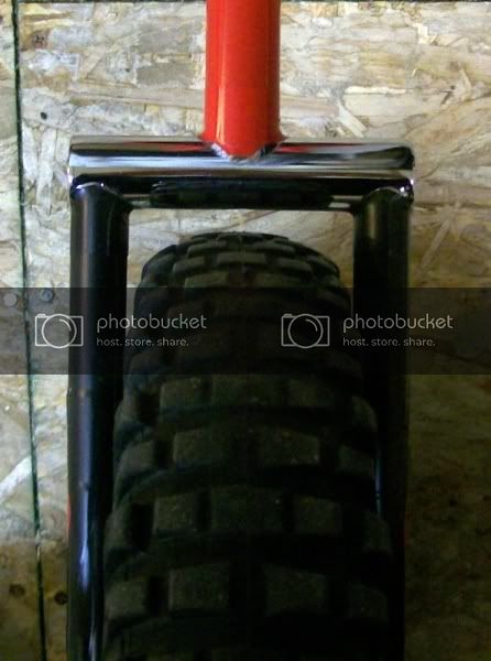

Here is a pic of my modified uni. I started with a stock Nimbus trials ISIS. So far I’ve broke the stock cranks (bent), couple of spokes, seatpost and seat and it has evolved into this. CF seatbase will be here shortly.
The color on the frame is just nylon tape, kind of fun and protects the frame a little bit, seems to hold up pretty well, looks pretty good from a distance :smiley: .

I think they should revise the longneck to take 25.4mm (atleast) seatposts. Only then would I consider it as my Thomson post wouldn’t fit. Looks like you’ve got a pretty sweet ride though. You said it looks good from a distance… how about close up?
It’s about 8mm top and 6mm on the sides. I think about exactly the same as the Nimbus II. The Nimbus II might have a little less clearance at the top, but the top of the X frame is closer to the tire.
