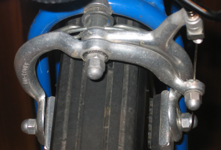

I don’t want Maguras or anything too complicated/expensive because I hardly ever use the brake anway. Here’s a couple pictures of what I’ve got now. I’m hoping to replicate it on the Nimbus frame. It’s an Odyssey 1999 BMX brake drilled through the seat tube. It came with 2 bolts, one short and one long. I think I’m using the longer one. The brake pads are not too grabby at all, which is nice. I’m thinking it will work if I mount it on the front of the frame as suggested.

Would you say there’s enough clearence for the brake to be used on a 24 x 2.6 tire? Also, could you take a picture of how you set up the brake lever?
Not sure. It would be a tight fit if it did. The pads are far enough apart for pretty much any rim (the tire can be deflated to pass between the pads), but the knobs of your tire might rub the lower part of the brake arms. I did a quick test on my 2.5" trials tire and it seemed pretty close to the limit. The brake lever is mounted to the left handle of my T7. Others have recently posted pictures of that setup… mine looks the same.

I was able to drill through my Nimbus 36 at the crown to get my caliper brake mounted:
It doesn’t seem to have structurally compromised the frame at all, so I think that’s a pretty good deal. I considered putting it on the rear brace like the above poster, but I thought it’d compromise the frame too much there. Guess I was wrong :). It works either way, I guess. However you want to crack it! :slight_smile:
