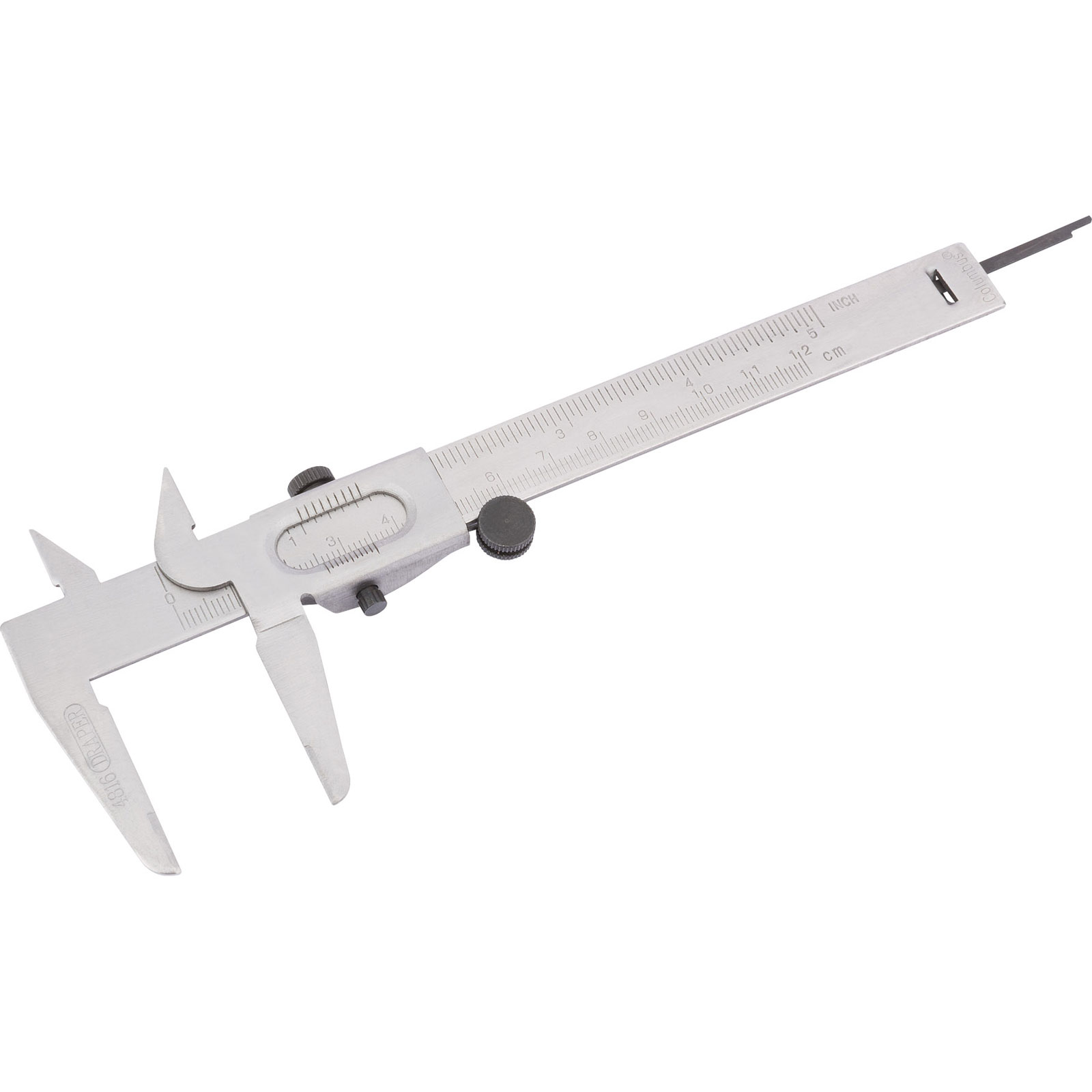

You could buy some caliper gauges and measure it. Only a few Pounds/Dollars. That’s what I have.
This type of thing:
Hey, now that’s useful!
Think that’s what I’ll do once I get to doin’ things.
