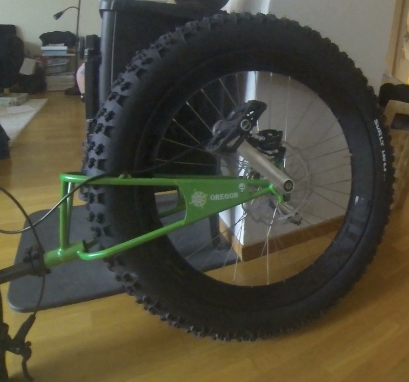

Here is the second, a 26", 90mm wide, 36-hole carbon rim. I buildt this wheel last september, but have not tested it yet… (…was actually waiting for the new Schlumpf-hub). Anyway, when having such a rim in your hands, and bulding a wheel, you get high expectations…
http://www.nextie-bike.com/fat-bike/26-inch-wheels/carbon-fiber-fatbikes-rim-90mm-width-tubeless-ready-double-wall-wild-dragon-nxt90wd
It’s strong, and stiff, no doubt, but Im not sure it have the proper flex for the really really big drops (Im just asking that question due to the differences between building a wheel with a carbon rim and a “regular” rim. But, its probably so strong that it wont be any problem for most of us…). It’s allso kinda expensive rim regarding testing out the limits…

I stumbled upon them when doing research for my fat unicycle and it would have been in my parts list for the ultimate build (it is just twice the price of the Surly Clown Shoe – not bad for a carbon rim).
However, budget and 125mm hub requirements lead me to go safe and settle for only 82mm aluminim :stuck_out_tongue:
