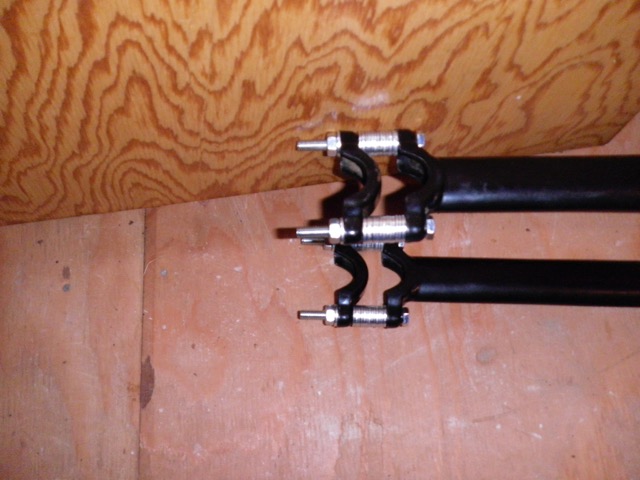

If it doesn’t fit you can always do something like this:
That was to use a fat 29" wheel in a standard 26" MUni frame. It felt perfectly solid but I don’t think I would want to use that system long term.
( I used another set of stamped bearing caps facing the other way to hole the wheel.)
