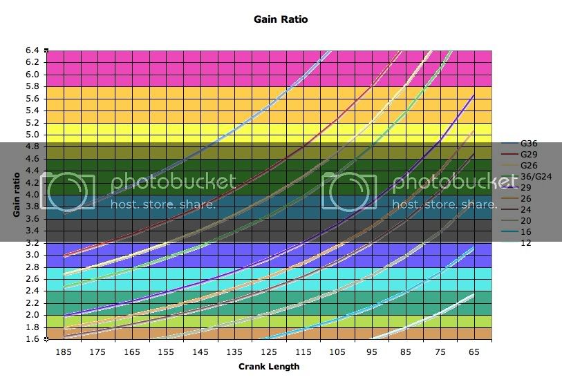

New concept: Total Gear Ratio
Are 92’s a bit extreme because it’s a 26 or would that be the case regardless of wheel size?
If it depends on wheel size, then it would be cool to modify the chart. For each column in your chart you put a line showing the longest “recommended” crank length and a line showing the shortest?
I guess even if it doesn’t depend on wheel size, it would might be nice to have those lines… just straight across.
That would make it more obvious that although I might have the same TGR (26 with 90’s and 36 with 135’s both equal 3.39) I might be going too extreme with one.

When I first made the chart I highlighted the crank lengths from 165 to 110 since that is what I like to use but decided to undue the highlighting because some people like to crank away with 185mm bike cranks for big wheel MUni and some people are really good at spinning little wheels with ridiculously short cranks.

Firstly, I personally think that 92’s are not really extreme on a 26". Sask must be with me on that one, or his colour coding in the table is wrong. 92 on a 26" show between “allround road riding” and “hilly road rides”.
Secondly, it DOES depend on wheel size. That’s the whole idea of Sask’s table and the colour coding in it. E.g., 165 mm cranks make good sense on a geared 36" but not on a 20". Those lines you’re talking about are already in the table, as the borders between differently coloured areas. But it’s not a black and white picture, literally.

It does seem to make sense like that, if you want to see the results of swapping cranks from one uni to another. And your point is especially clear, if those cranks are fairly extreme (165) for a particular uni (20).
But if I am looking to get different cranks for my uni to match the TGR of another ride, I might find there isn’t anything prohibiting me like pedal strikes. For example, if I want a 26 to have a TGR of a G26 on flat roads (green), I look it up and see I’d want a TGR between 4.13 and 4.50. Looking back to the 26, I see I can get 4.40 with 75’s. But wouldn’t that be significantly less comfortable to ride?
(I really don’t have the experience to say, I just gather from these forums that that would be a bit extreme.)
Not exactly clear to me which two setups you are comparing. One is a 26" with 75 mm cranks, I think. The other a geared-up 26"? With what cranks?
Anyway, for most people a 26" wheel with 75 mm cranks will be less comfortable to ride, especially when one wants to ride fast, than a bigger wheel (say, 36" - or a geared-up 26" for that matter) with the same TGR. OTOH, ride comfort is also a matter of getting used to a particular setup.
TGR is a mathematical number referring to the total gear ratio resulting from crank size, wheel size and gearing. It can be construed as an approximate indicator for speed potential, but “at your own risk”. In any case, it is not an exact predictor for maximum or cruising speed. Even less so (I think), it is a predictor for ride comfort.

For those of you who prefer graphs to charts
matched the colours as well as I could to the original chart.
I love this whole concept and the chart is amazing. I think it would be really interesting to disect the 29" format where these numbers would end up being vastly different from set-up to set-up. I have 2 29" tires that measure almost 2.5" inches in diameter different. By these calculations my Kenda Kwest with 125mm cranks only comes out to 2.69(measures marginally better than 26.5"), which only makes it slightly better than a 26" with the same lenght cranks, whereas my Schwalbe Big Apple 29 (actually 29") gives me a much better TGR for cruising at 2.95 with 125mm cranks.
