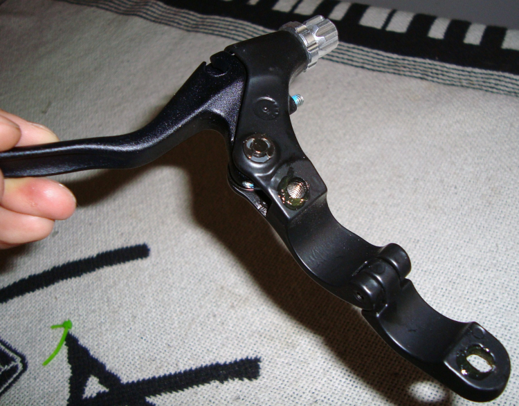

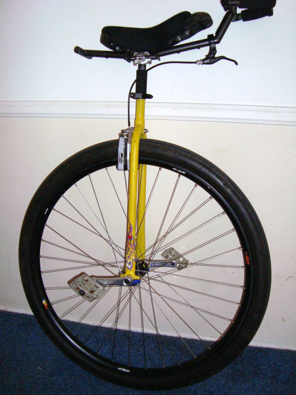

I wanted to relocate my brake lever on my 36er’s T7, but to fit it below the “T” wouldn’t work-until I found the lever, pictured below! I got a pair of them for just $15 at my LBS. I like this new location better for a couple of reasons.
I’m less apt to accidently squeeze the lever when going to grab the handle. I can now use the same length cable when I get the new coker handle, since that configuration uses the underside of the saddle for mounting the lever, instead of the bars. Oh, and I MUCH prefer this 36er to the new Big One I recently had…and sold! Not that there’s anything wrong with it. I think the new coker is a great uni, but I just prefer my Rockin’ Radial! :smiley:
soa~weetness i wish i had a cool ride liek that to attract all the ladies like terry does;) :wink: :stuck_out_tongue: :smiley:
How do you squeeze the lever in that position? It’s not anywhere close to your hands…
And I have to say, I’ve never accidentally grabbed the lever going for my handlebar. Is that a common problem?
Haha, no I haven’t actually engaged the lever, but have come close a couple times. I also wondered if the new, lower location would pose any access problems, but to my surprise, it works out great!
I only use the brake on rare ocassions, but when I want to use it, my hand seems to find it as naturally as if were mounted under the front of the saddle, as it is very close to that position. So, no problems. (I also really like the way it looks now a lot better than before lol!)

This position is only temporary unitl I get my new coker touring handle, which will allow mounting the brake under the front of the seat, like on my MUni. The T7 single bar is in the way and won’t allow for mounting the lever under the saddle.
What are those brake levers called?

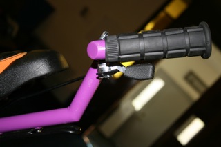

I got the idea to use friction shifters from someone else on the forum. Here’s my setup. The shifters work so much better for me then the traditional brake lever. On long descents, I just set the appropriate drag and pedal on without having to worry about keeping hand pressure on a lever. No more bump and throw.

Does that friction shifter accept the same cable as the brake lever, or do you need a different cable? And if I go to my LBS, would I ask specifically for a “friction shifter”, or is there another name for them?
It’s a different cable. Same gauge, just a different end. You LBS will know what a friction shifter (thumb shifter) is. You just want to make sure it’s friction, not indexed. They’re really inexpensive and you may be lucky enough to get your hands on a used one for a couple of dollars.
You’re looking for something like this. http://aebike.com/page.cfm?PageID=30&action=details&sku=LD1243
Keep in mind there is a left and a right, so you’ll want to think about where this is going to be mounted and how you want the lever to rotate.
