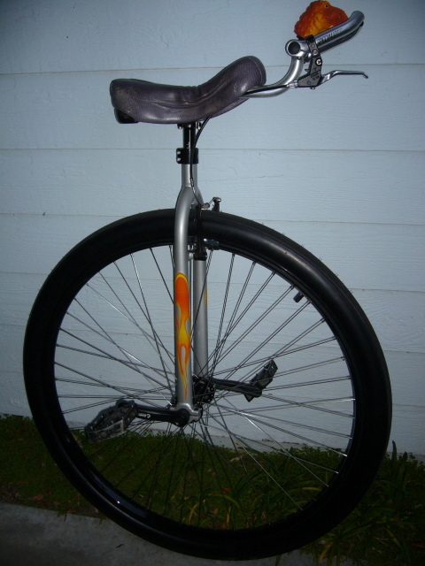

Just picked up my new Coker from Jamey. It is extremely light and the New road tire is much faster and smoother than the regular tire. I do have a question for you experts out there. The back of my thighs hit the top of the V-brakes when I pedal. Coker has you put the brake in front. Is there a downside to flipping the whole uni around and putting the brake in back?
Looks cool! Where’d ya get that flame sticker? I assume you used you own cable/sheath to make it long enough to fit on the handlebar? But then since the brake is in the front, maybe the one that came with it was long enough? Anyway, I posted earlier today in another “coker arrived” thread, and here’s the post, which also touches on the brake issue:

I’m no expert, but I can’t see any problem with it. Just make sure you take the wheel out and turn it around, too (that is, make sure your left and right cranks are on the left and right). Otherwise, your pedals will loosen as you ride.
Is there anything on the frame itself that indicates the front/back? I’m assuming that the slot/gap in the seat tube faces the opposite way of the brake bosses. That shouldn’t be a problem.

Yeah, I wanted the brake to be in the back, so I just have the seat tube slot facing the front. No biggie since the seat clamp still works in either direction.:slight_smile:

Im wondering if there wasn’t a manufacturing error that got transposed into the present configuration. The v2 seems to have the brake mounts on the forward part of the frame. Possibly could have been the delay in release of the Big One along with the V2. A crafty engineering department might just have done a fine job here.:slight_smile:

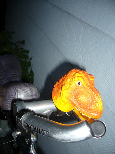

On another note, is that a T-Rex head on the top of your handle?
Haha yeah, I gave that to Jim for his 50th b-day.:smiley: Honk it in good health James!
Terry, My paint is perfect, the wheel is straight and true. I am very impressed. As for the brake cable, $5 at a bike shop gets you a long one. Coker designed theirs for their mount.
It looks like the conseses is that the brake behind the frame is ok. I’ll flip things around and see how it works. Dang, I cut my cable so now I’ll have to swing by the shop!

I had the same problem as you and so I did flip the seat/seat clamp around and swapped the cranks left to right and right to left and it rides so much better now!

I’m sure Coker would send you a new tube, takes 5 minutes to change. Flip the frame around, brake problem solved. So is it just the paint drip left. You’ll have so many scratches or you’ll paint it so it won’t matter! I think you are giving up on it a little too fast.
brakes on backwards is probably because they modelled it on a bike front fork. Like everyone says, 5 minute job to turn the frame round, fit a brake cable.
