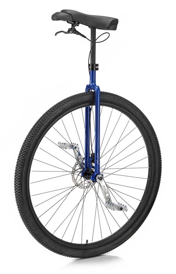

There is something I noticed by looking at this picture : (from kris holm website)
or even this picture of 36er riders (hello Nathan and Kevin :slight_smile: )
I see a gap between the top of the tire and the frame that seems somewhere between 1/2 inch and 2/3 inches…
But when I look at my G36 :
The gap is only about 3 mm.
The rubber pins are even rubbing against the bottom of the frame.
I have the latest kh frame.
What does it mean?
Is the new tire bigger in diameter? does it come from the rounder shape?
Or for a reason my frame is shorter than the others?
I measured the diameter of my tire at 920-923 mm = 36.22 - 36.33 inches.
I guess I have to change the setting of my cycle computer, it has been programmed for a 914.4 mm - 36.00 inches diameter.
With respect to the shape of the new tyre, I noticed that the profile had changed. The tyres that I had on my 36er mountain bike were flatter.
On the subject of the overall diameter, I also noticed that the new tyre is bigger. There is less clearance to my old Nimbus Nightrider frame than the TA tyre. I have the measurements from my previous Nimber tyres on the frame drawings I did for my 36er MTB. I will dig them out and check the measurement.
It’s pity and slightly annoying that the tyre isn’t suitable for the older rims. Heyho.
Sorry, but I did not get it. Will there be a 32" Version in the future or not?
THX!
I don“t think so. You have a Maggi mount on your frame. 2017 KH frames do not have them anymore. Only disc mount tab and cable holders.
Then the crown to bearing holder distance might have changed as well …? KH also changed the clearance (width) on the 27,5 and 29 frames in 2017.
You are right, I wasn’t aware there was a 2017 frame, and didn’t notice that magura mounts have disappeared, which in my opinion is a pitty.
But what? The distance from bearing to crawn was higher (nathan’s yellow 36er for example) then shorter (mine ? ) then higher again?
And Fat D noticed an increased overal wheel diameter with this new tire too, so maybe it’s a combination of both explanations ?
Found the reply from Kris in the ā€œ2017 KH lineupā€ thread and just copied it:
Here are the vertical clearances for KH frames, measured from axle to underside of crown:
KH20: 268.5 mm
KH24: 338.5 mm
KH27.5: 383.5 mm
KH29: 401.5 mm
KH36: 463.5 mm
Then you can measure if your frame is the same or not. Hope that helps to clarify.
Thanks.
I measured it approximately, and it seems to match.
furthermore, 463.5 of radius x 2 = 927 mm diameter.
so the 2017 frame can take up to a 927mm wheel (with no clearance).
Let’s take my smaller measure of the wheel with the new tire : 920mm diameter.
927-920 = 7mm
I see a clearance of 3-3.5 mm between the top of my wheel and the fork, but it’s a radius, so if I multiply by two it gives 7mm as well.
It sounds like the 2015 kh36 frame has the same ā€œaxle to underside of crownā€ distance as the 2017.
And it also sounds like the wheel is definitely bigger.
waiting for confirmations from Kris and from UDC
