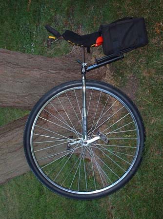

For speakers/storage I have used a bicycle rack/trunk before:

George Barnes, you’re my hero. I think I really like what you have going on there, based on the idea that the trunk arm can be optional. If i don’t need it, I can take it off. I can put it back on when I do need it.
I did some web searching for rack trunks and found plenty, but they all have support arms that go down and attach to the axle of the bike’s back wheel. Can you give me a clue where you found just the arm that clamps around the seat tube?
Most bike shops will have racks that only attach to the seatpost. The racks are typically for use on mountain bikes that have a rear suspension but they can be used on any bike, or on a unicycle. Shop around and look at the different makes and models. Some of them are more angled than others. On a unicycle you’ll want one that is straighter since our seatposts are vertical and not angled back like a bike.
Here is a seatpost rack from Performance
<http://www.performancebike.com/shop/Profile.cfm?SKU=13280>
There are of course other brands and designs.
