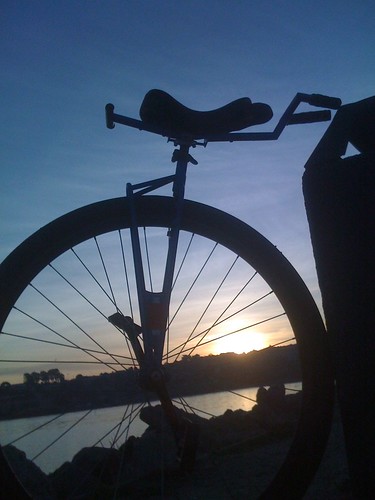

My new KH/Schlumpf 36!!!
John - My wheel is not as stiff, but that is simply because it is a loose wheelbuild, I am bringing it by the LBS to have it tensioned today. Even with a loose wheelbuild though, I didn’t notice any problem with it flexing, it feels great(this may be the fact that Ken said that the frame is quite stiff). Most of my experience has been on the extra wide hubs, but it feels a lot better having a narrower hub. This set up is amazing, and I can only imagine how great it will feel having a 29er tube, shaved tire, and my mg-1s.
Ken - After riding my kh/schlumpf 36, I don’t think I will ever yearn for an ungeared 36 ever again. :sunglasses:
And yeah…so far no knee problems! It really does feel like riding a bike and I haven’t had sore knees yet, but I only took it out for 10-15 miles yesterday.
I took it up some hills yesterday and I definitely feel the weight of the wheel when trying to climb in high gear, having a lighter tube may help, but climbing in high gear feels like riding a heavy/slow bike. Simply shifting into low gear makes everything nicer though. Riding in high gear on flat or slight downhill or slight inclines feels amazing though.
