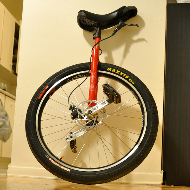

This is what is looks like now:
I also have the Duro 3" for intense off road, but for 90% of the riding i do with this unicycle the hookworm seems to be the best you can get…
Buy the Muni and put a road tire on it, it has a wider frame, so it easier to select what you want later.
That is a good combo. It would be a good choice if… you ever want to run larger than a 2.5" tire; you want to be able to easily add brakes in the future; you don’t want to run a tire smaller than 2.25".
The Hookworm tire will also fit the Nimbus II frame. The 24" model used to come with a Hookworm before the tire was discontinued in that size.
The Nimbus II would still be a good choice if… you don’t expect to ever run larger than a 2.5" tire; you don’t expect to add brakes; you do want to be able to use a 1.95"/2.0" tire, and not worry about it blowing off the wider muni rim.
