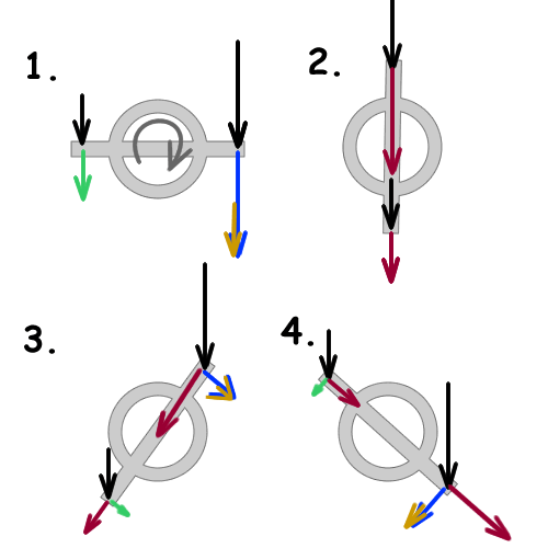

"1. Cranks at 3 o’clock (horizontal). Pressing down on the front pedal will cause the cranks to rotate in the direction that we want them to go. Pressing down on the rear pedal will cause the cranks to rotate in the wrong direction. If the force on the front pedal is greater than the force on the rear then we’ll get some rotation in the right direction. Any downward force on the rear pedal has to be overcome by downward force on the front pedal before any effort is actually used to propel the bike forward. Remember that.
  1. Cranks at 6 o’clock (vertical). Theoretically pressing down on the top pedal won’t cause the cranks to rotate but in practise it will because the position is unstable. Whether it causes them to rotate forward (to 3) or backward is anyone’s guess. Pressing down on the lower pedal will not cause the cranks to rotate - in fact it will stop them.
  2. Cranks between 1 and 2 o’clock. Pressing down on the top pedal will cause the cranks to rotate in the direction we want them to go - but only a small part of the force will contribute to the rotation.. The rest of the force is wasted. Pressing down on the bottom pedal will cause the cranks to rotate in the wrong direction - but again with only part of the force. As long as the force on the top pedal is greater than the one on the bottom rotation will be in the right direction.
  3. Cranks between 4 and 5 o’clock. Similarly to 3, aproportion of the downward force applied to each pedal will affect the rotation, the remainder will have no effect."
"In the diagrams above the direction of travel is left to right (as with the animations below). The black arrow represents applied force. The coloured arrows show the applied force resolved radially (in red) and tangentially (in blue and green).
Bad pedalling works because the blue arrows are longer than the green ones. The effective contribution is blue minus green, I’ve shown that in amber. The amber arrows represent the ‘torque’.
Bad pedalling is bad because all of the force represented by the red and green arrows is wasted.
The aim of good pedalling is to modify the direction of the black force to minimise radial forces and maximise torque."

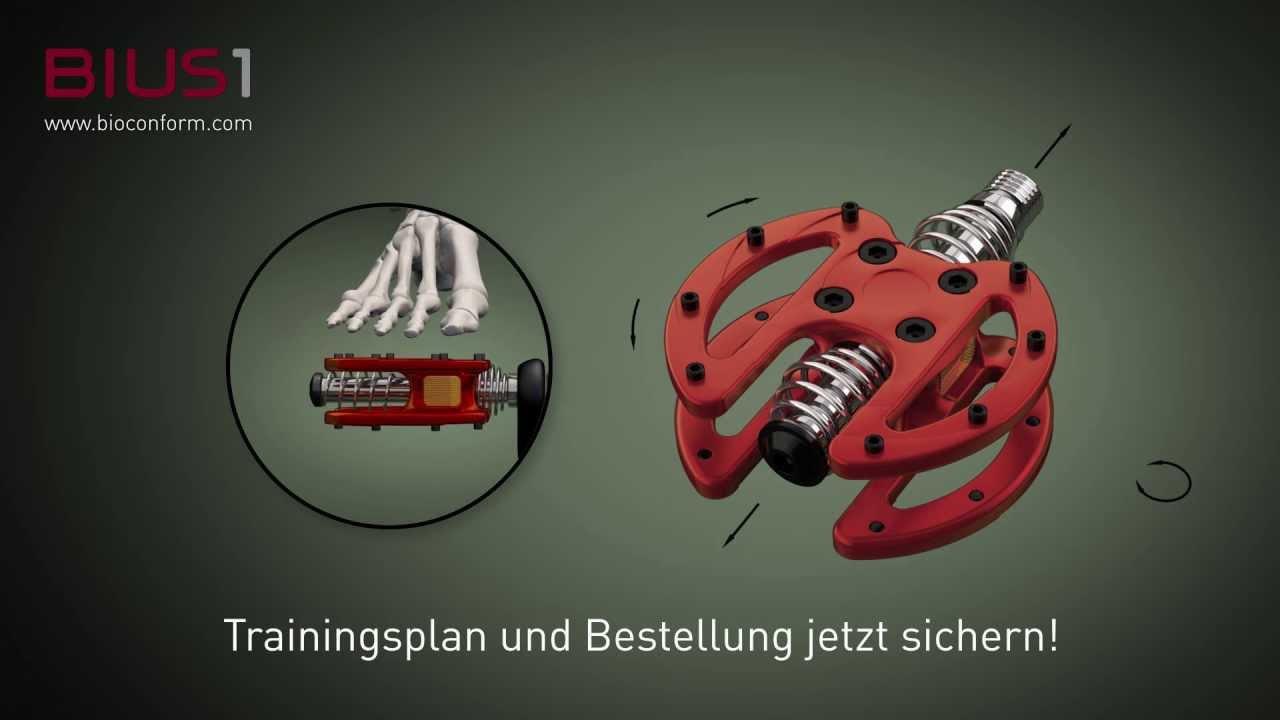

In fact I just found this :
Here is a video showing how it works :
It is expensive but this video makes me feel trying this on a unicycle, it could be cool for my duck feet

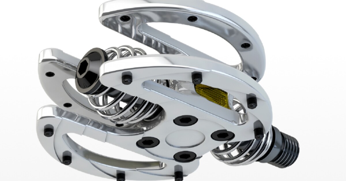

Those platform pedals can twist and move laterally, increasing Q-factor at low position.
These pedals looks interesting…
I just wonder if it wouldn’t feel weird and impair control when riding without handlebar…
Anybody ordering from outside Europe should get a 19% discount as usually VAT does not apply :smiley:
Do you really want your knees bounding outward like that at the bottom of the stroke? Seems like that’d wreck your knees (and ankles/feet) far worse than keeping your feet semi-locked on an SPD pedal.
Well I don’t know.. I was only looking for flat pedals that can twist a bit.
The only thing I can say is that since I use 27mm pedal extenders, even on spirit cranks that already have some Q-factor, I feel very much comfortable and I’ve got better control.
But it’s locked, I have no idea how it feels to ride unicycle with BIUS1 Pedals and it is too expensive for me to be the first reviewers :smiley:
This is something more related to duck feet issues than with easy pedaling, so I guess we are a bit off topic.
